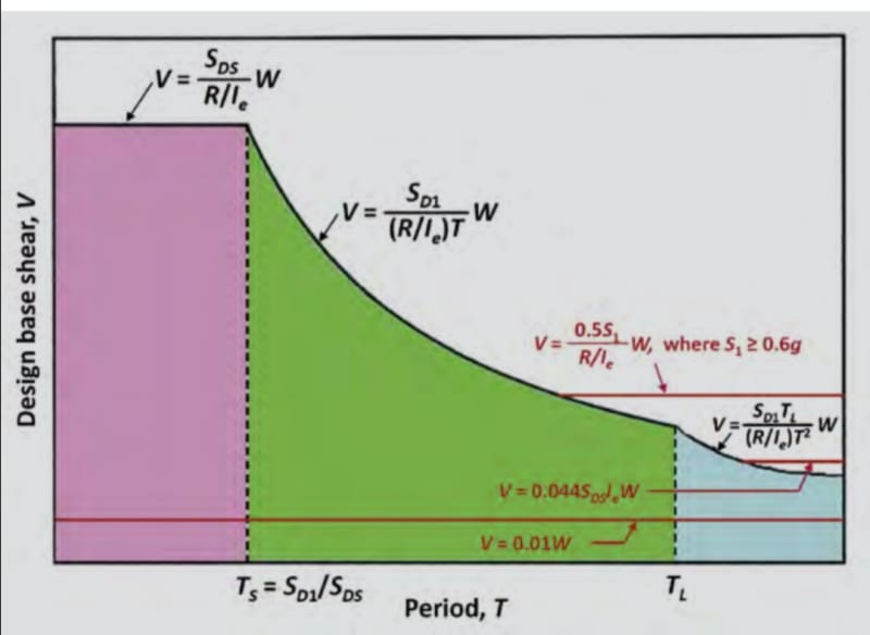

I still am not seeing how ASCE7's ELF procedure is dependent on the period of the structure save for the maximum bound on C[sub]s[/sub]. S[sub]DS[/sub] is site specific and R is based on the SFRS so unless you hit the maximum bound on C[sub]s[/sub], there is no correlation between structure period and base shear.

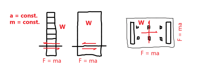

By Newton's Law? Just fun to open up discussion - why direction matters.
Another phenomenon to think about - a cantilever H beam (Ix ≠ Iy) subject to same magnitude forces in x and y axes, what is the resulting shear force at support in each direction?

I still am not seeing how ASCE7's ELF procedure is dependent on the period of the structure save for the maximum bound on Cs.
From figure uploaded by josh, the relationship between Cs and time period is pretty clear. Here's another one. Same thing, but labelled with base shears and time periods as per ASCE7-10
