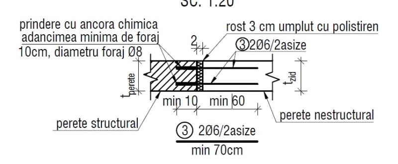

That means that on every intersection with the RC structure will be a vertical gap and all of the walls are not connected on top with the slab. Now you have to take every wall and calculate it for a seismic perpendicular force (from its mass) and you will have the top edge free.
I don’t understand why walls are not connected at top with slab? I thought isolation was being achieved from column ends only and any lateral pressure on wall will be resisted because of friction force at the wall ends. This way it could span in one-way direction between top & bottom beam/slab. Also, the vertical load from beam/slab will help reduce the tensile stress produced due to lateral loads and if the walls were designed to be adequate in shear & flexure, wouldn’t stability issue get resolved automatically? Can you give me some numbers about the expected resistance of an unreinforced or reinforced masonry wall for a typical story height and magnitude of pressure that is produced due to any earthquake load?
About the vertical gap, I was also wondering how long this gap should be and what is this compressible material they filled it with. Does the end result successfully withstand the environmental conditions like rains.

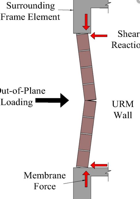

No, because the capacity is dropping way faster then the reduction in mass (force). And also the thin bricks have a nut and feder connection that is worse then normal one.
This only work with wind - you have the top and bottom end fixed and the left and right free and so its a one way slab and the wall will bend and take the force. But with earthquake it's other thing - you have what is called story drifts that means the top slab will displace 2-4cm horizontally (not vertically) away from the bottom slab. So if the wall is fixed top and down a displacement like that will break it.

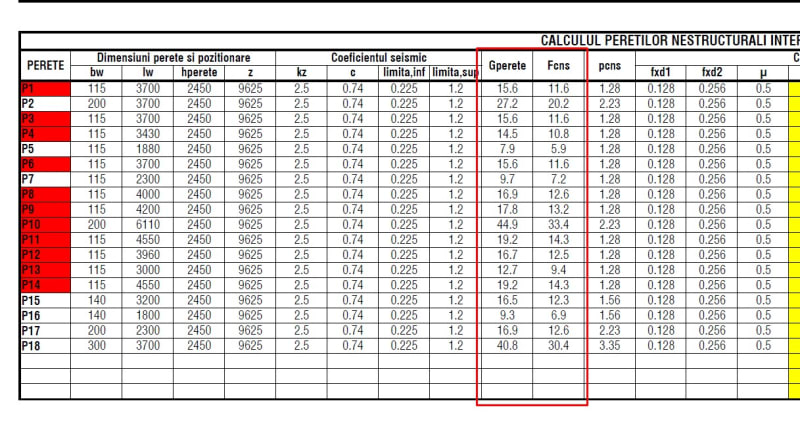

Gperete is the weight of the wall in kN and Fcns is lateral force. So for example a 15.6kN (1.56 tones) masonry wall 2.5m height, 3.7m long and 11cm thickness will have 11.6kN (1.16tones) demand. This is the 4th story and with every story the forces are increased by about 20%.
Something like rubber. There are some special membranes. From the top to the bottom.
Blackstar123 said:
By soft joints do you mean contraction joints? I didn’t know these kind of joints are also provided in masonry walls.
See below top view section :
In the left is the RC element and on the right is the masonry wall. Between them is a gap of 3cm filled with soft material (like rubber) so that the 2 parts are not structural tight.

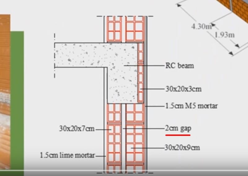

bones206 said:
Watch the bare wall on the right between 1:00 and 1:04 in this video. It kind of illustrates what I mean:
I know this video, thanks for sharing. I think the masonry here is build in a nonseismic way from the start. Look here :
There is no way and arch will form with a 2cm middle gap. Its crazy.. and the PGA is 1.0g - extreme.
That simulation is amazing but you're right, it doesn't help much for designers. It just confirms how poorly the masonry performs in an earthquake. Hopefully the ongoing research in this area will lead to some life-saving (and economical) design innovations in the future.
