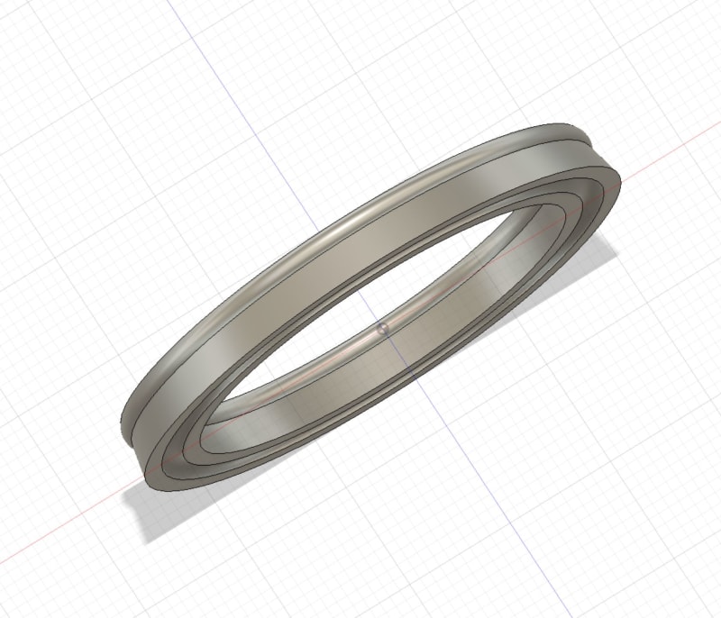

I am looking for the proper type of seal for an annular hydraulic piston that might be used in a bolt tensioner or concentric clutch slave cylinder? I have seen that some bolt tensioners use piston o-ring seals in the inner and outer walls and concentric slave cylinders use a seal underneath -possibly a symmetric double lipped type seal. I am more interested in the underneath type seal as it would be easier to design around and implement. Is there a specific name for this type of seal? Thank you, Gil

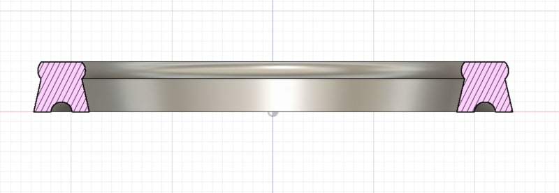

I took a concentric slave cylinder apart and measured the seal. I recreated a CAD drawing of it (see image). It is a symmetrical seal with a grove on the bottom and flat on the top.
The seal flares out on the sides

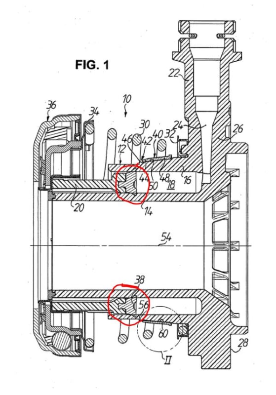

I also found a cutaway view of a concentric slave cylinder and circled the piston seal location in red (see other image).
That would be a symmetrical rod or piston seal. Sometimes called a u-cup seal. The attachment to the end of the concentric piston is probably a special feature.
