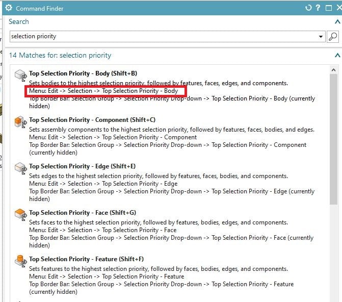

My grasp on it is that selection priority isn't a default but controlled using the toggles or hotkeys.
See image below.

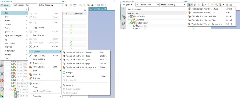

The priority thing is my guess too.
I have a model where I extracted the body and when I switched the priority to BODY the extraction was selected when hovering over it.
It will help things out if you have the selection priority on your menu bar.
If I remember correctly there was a slight change within NX at how priority's are handled from NX12 to NX1899.
