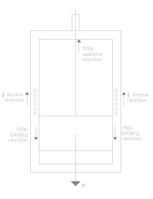

I think the ME is right. The reactions are all still following the same load path, they just jump up to be a lot higher. You end up with a 150k compressive force in each side of the yoke, and the numbers will still balance. (300k up on the gate results in 25k/anchor up; 300k down from the operator gets transferred through and down the yoke to the anchors for 25k/anchor...assuming 12 anchors).

Summation of forces in the Y:
W+Binding Reaction-Anchor Reaction-Operator Reaction=0 .
W+Binding Reaction=Anchor Reaction+Operator Reaction
W+2(150K)=Anchor Reaction+300k
W=Anchor Reaction
If the gate is crumpling, you have bigger problems than mounting.
Another way of looking at it: if this were not bolted to a wall and it were to bind, would it start moving across the table? No, because there's no net external force.
The clam shell thought is certainly valid, but that's a result of the eccentricity between the yoke and the stem. So long as the yoke is sufficiently stiff to prevent distortions or significant deflections, you'll end up with an insignificant (but probably non-zero) change in anchor shear.

AskTooMuch - that's true only if the motor and the gate are mounted independently. In that case, the only load path is through the anchors. In this case, the load path is through the 'self contained' steel yoke.
I dont agree, I'll get back in this thread later after others posted. For now it still looks to me the 300k "stuck loads" is transferring to the anchor bolt.
Agree with phamENG: the loads are entirely resolved internally. Maybe I am on glue but in order for the shear to flow through the anchors in the stuck position the entire assembly will need to want to lift up right? Well, the force is net 0 vertically due to the binding just offsetting the winch force (with bolts originally taking the W) so I dont see that being possible.

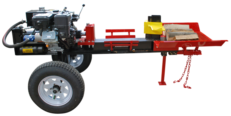

It's like a big wood splitter in reverse. How much are the wheels working when it's pressing through a hard piece of wood?

For anyone who thinks there's stuck load on the anchors....can you provide a FBD that shows the additional reaction?
Sbisteel.....That is a good visual. I'm 90% with you and Pham. Let me think on it.

The picture of the gates above are not self contained gates. The vertical forces on those cantilevered slabs are going to be immense. As a matter of fact, I question if they're adequate. But it's apples and log splitters.
