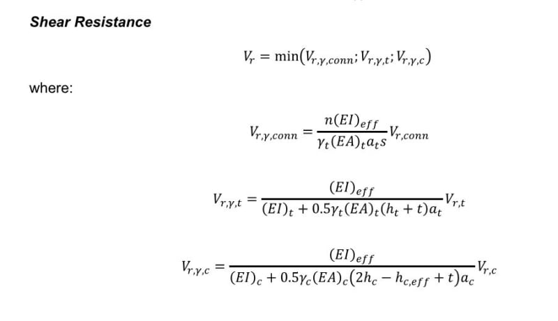

Timber beams 180 x 240 (no spacing between), on top plywood and RC slab (70 mm thic). Connection between slab and timber are nails as shown bellow.
How do I calculate shear capacity per 1,00 m (kN/m) for such composite ceiling?

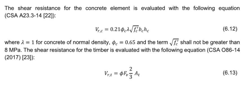

But I'm having trouble determining for positive bending what Vr,t and Vr,c are in equations 6.14 and 6.15, as cannot find it in the guide proper. In the example I think they work through it, but just stated the value for Vr,t (any chance you could confirm thats just the stock standard normal shear capacity for timber.
Being familiar with Canadian ways, are they the individual shear capacities of timber and concrete determined normally on their own in isolation (from appropriate codes, the only equation given in the example is for the Vr,c concrete shear capacity and not sure if that is a capacity just for this purpose or from concrete code or something?)
I'd need to work through the rest of eqn 6.14 and 6.15 to see how much the multiplier might be over any above the bare timber or concrete shear capacities. In the example, the composite shear capacity comes out lower than the bare timber, as it was limited by the concrete shear capacity. I guess it's analagous to a flitch beam, in that you're after the composite capacity when one of the materials/components reaches it's limit.

Please note the constrain "minimum of": MIN(Shear Flow, Concrete Shear, Timber Shear). IMO, unless the concrete is very thick and strong, it would not govern in most occasions. (I could be wrong though)
In the example the concrete governed the shear capacity.

In my opinion, OP still won't be able to use this methodology for lack of solid testing & recommendation's for the fasteners he's got. This stuff is fun to kick around, and I try to help where I can, but I still suspect that the path forward for OP will be timber shear capacity alone.

I'm afraid that I won't be able dive any deeper on this until the weekend, and may not even then if some of the bicycle parts that I have on order show up as planned. When I do a quick scan of the relevant equations, however, they strike me as follows:
1) Stresses calculated based on some manner of partially composite sections.
2) Individual material stresses from [1] compared to conventional limits for those materials.
The equations have that "flavor", you know?

For shear capacity of concrete and timber, see equations 6-12 to 6-15, on p.54-55. I've not get to the example yet.
I can confirm that this stuff is standard, uni-material capacity value per Canada's standards.

EDIT - not sure how I missed those 2 eqns, but good to know they are stock standard, as helps with possibly applying logic to other regions.
