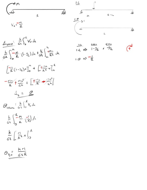

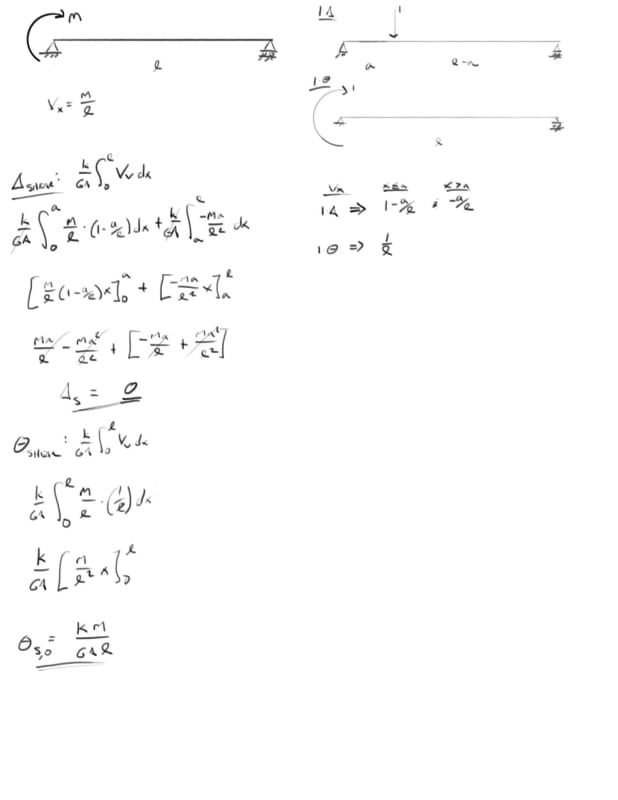

This is probably something that is very easy and I am way overthinking it.
I've done the unit force method which shows that the shear deformation from a point moment is 0 at all locations on a simple span. I've done the same thing to show that the shear component of the slope at any location on the beam is constant = k M / A G L. Here is where I get hung up if the slope is constant and non-zero why is the deflection 0 from a math stand point, the mechanics make sense to me but I'm lost in the math on this one.
I have a great mechanics of materials book by Timoshenko and Young which for me so far has the best break down of shear deformations I've been able to find and in there they present that the slope due to shear is simply dy/dx = tau,max / G = k Vx / A G, which aligns with my unit method solution of k M / A G L.
integrating that once yields: y,shear = k M x / G A L + C1
Initial conditions are x=0, y=0 and x=L, y=0 the first condition yields C1 = 0, however the second condition yields C1 = k M / A G ... so I get that something is missing here which would should result in y,shear = 0 but I am at a loss.
would greatly appreciate any insight on this one.

"I've done the unit force method which shows that the shear deformation from a point moment is 0 at all locations on a simple span."
how can this be true ? the point moment is reacted by a couple (at the reactions), therefore there is shear in the beam.
why use unit force method on a statically determinate beam ?
I don't understand what the two sketches on the RH mean ? It looks like you're calculating reacting for a unit shear applied at a point a ?
On the LH it looks like a 1/2 hearted attempt to calculate slope …
Lay out your calc clearly so we can follow …
with M applied at A, the reactions are Rb = M/L and Ra = -M/L
the moment in the beam is M(x) = M-Mx/L
then v(x) = int M(x)/EI = M/EI*(x-x^2/2L) + C
and d(x) = int v(x) = M/EI*(x^2/2-x^3/6L) +Cx+K
d(0) = d(L) = 0 … K = 0 and CL = -M/EI*(L^2/3)
then v(x) = 0 at x-x^2/2L-L/3 = 0 … x^2-2Lx+2L^2/3 = 0 … x = L(1-1/sqrt(3))
or something like ...

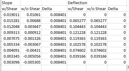

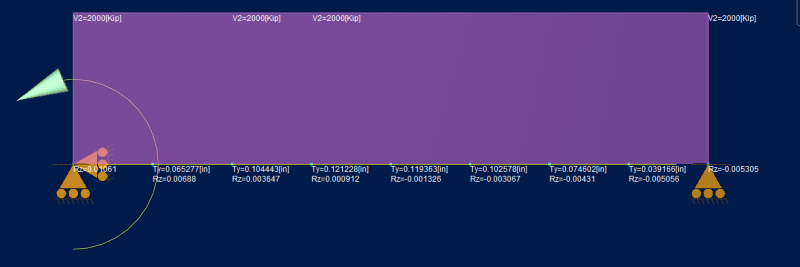

you've gone thru the derivation of the slope and deflection due to bending, I am looking specifically at the shear deformation.
I've verified my constant slope due to shear = k M / G A L and deflection due to shear = 0 with various text sources and software. Problem with the text sources is the info is simple shown as a table of values associated with load types and there is no actual derivation or explanation provided.
W/ Shear Deformation:
W/O Shear Deformation:
Delta between the two:
Computer Calculation Parameters:
L = 5 ft
M = 10000 kip*ft
Beam is a W36x135 - k / A G = 4.18x10^-6 kip (A/k = web area = 21.36 in^2 and G = 11200 ksi)
The purple diagram is the internal beam shear

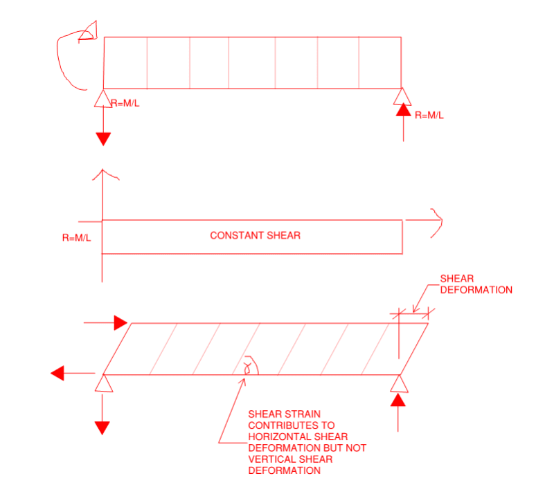

1) In general, you don't need a change in shear to have shear deformation. All you need is shear. Shear begets shear stress; shear stress begets shear strain; aggregated shear strain begets shear deformation. The conservation of energy makes this pretty much a law.
2) In particular, you do need a change in shear in order to have vertical shear deformation in a simple span member. More specifically, you need a reversal of shear, not just a change in shear. This is really just the satisfaction of a boundary condition when both supports are at a common elevation. If shear deformation takes you off at a particular slope as you leave one support, there's just no way to land at the other support unless you reverse the slope at some point. Note that a cantilever can have a uniform shear diagram and still have vertical shear deformation.
3) The sketch below, studying only the shear component of deformation. shows where the shear deformation goes in Celt83's case. I believe that the source of his mathematical discrepancy may be that the unit load method, being an energy method, should take some account of the energy represented by the shear strain shown below. That energy input, however, will not contribute to vertical shear deformation.
