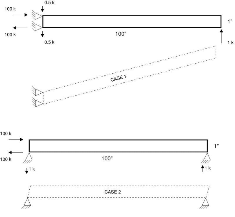

I propose that the deformed case 1,2 & 3 cubes below are identical in every way except for a rigid body rotation. Case 1 doesn't have "horizontal" shear strain, and case 2 doesn't have "vertical" shear strain. All three have the exact same shear strain. In fact strain is a scalar quantity, and has no direction (even though it can be positive or minus).
It is not until the boundary conditions determine the rigid body rotation that we see what the final orientation is.
Likewise, (as far as shear strain, stress, deformation goes) case 1 and case 2 are identical except for a rigid body rotation.
I don't see case 2 deflecting that way. Maybe if the load was applied near one support and reacted at the other.
The difference I see between case 1 and case 2 is that for deflections (and I mean the beam bending deflection) to be the same, then case 2 deflection are determined with respect to the tangent at pt1. In case 1 the deflection is monotonic increasing from 0 at pt1. In case 2 I see the beam sagging down at pt1, reaching zero then increasing to pt2.
The sketches just show shear deflections, with opposite faces of any segment remaining parallel.

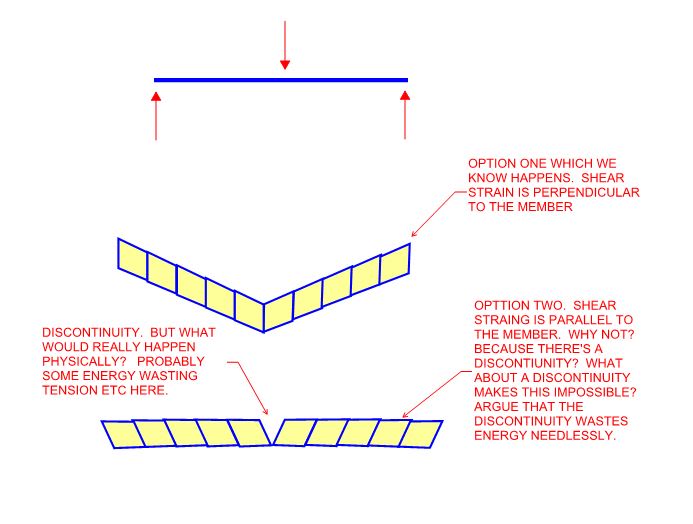

KootK said:
If you're stuck on the continuity thing in a hard way, then the mental experiment is pointless. Let's not discuss it any further..
Well yes, other than providing insight into how the non-intuitive behaviour under shear deflections follows directly from the definition of shear strain and strain compatibility, all entirely pointless.
I didn't say that that continuity was pointless. Not once. What I said was that my mental experiment, which I was hoping you'd join me in discussing, goes nowhere and is pointless if you refuse to consider any scenario that violates continuity. If you refuse the starting premises of the argument flat out, then you've declined to engage and there's simply nothing to discuss.
Yes, I understand that continuity requirements rule out certain deformation modes. The question that I've been trying to drill down to is WHY does nature avoid continuity violations? Obviously, when continuity is violated, most things don't just explode or cease to exist. Rather, damage occurs. Things can in fact be non-continuous. My hypothesis is that, given the choice, materials organize themselves in a way that favors continuity because such damage would produce a condition in which expended energy is not minimized. I'm not suggesting that continuity doesn't matter. Rather, I'm proposing energetic concerns as the reason for why continuity matters.

You didn't. I did. Then, as now, I'm ready to let this one die off as it's certainly not provoked any of the interesting discussion that I'd hoped it might. And that's okay. Some ideas naturally dead end in any long running technical discussion.

Part of what I've been trying to get at with the energy/continuity business is that I really just see energy minimization as a further drill down on the continuity concept.
Axioms
1) Nature minimizes energy.
2) Continuity violations cause damage which consumes energy.
Premises
3) 1 + 2 --> Nature will enforce continuity when possible.
Conclusion
4) 3 ---> Loaded materials will organize themselves such that continuity is maintained.
I think that makes sense... continuity is only broken when the strength of materials is surpassed.

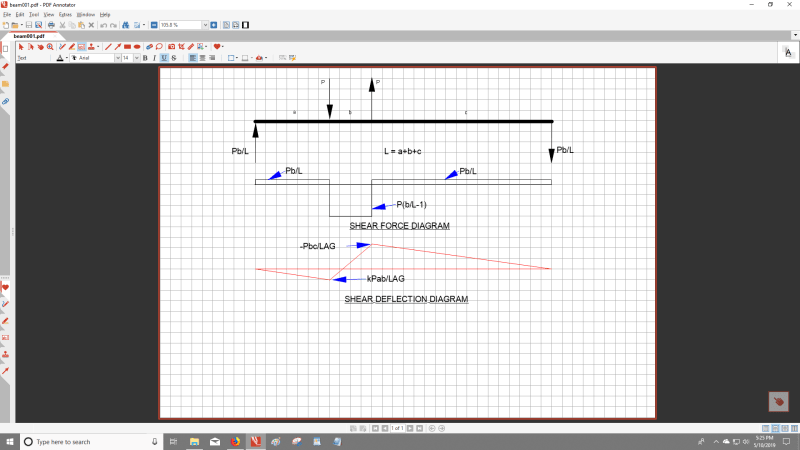

If two equal and opposite vertical point loads are placed on a simple span, separated by a distance b, the shearing force and shear deflection diagram are shown below. The formula dy/dx = kV/AG is used to determine slope in the three zones 0<x<a, a<x<a+b and a+b<x<L.
dya/dx = kPb/LAG; ya = kPab/LAG
dyb/dx = kP(b-L)/LAG; ya+b = kP[ab+(b-L)b]/LAG = kP(ab-(a+c)b)/LAG = -kPbc/LAG
dyc/dx = kPb/LAG; ya+b+c = yL = -kPbc/LAG + kPbc/LAG = 0
The two point loads produce a moment but not a point moment. If dimension b approaches zero, the slope, dy/dx approaches zero in Range a and c and shear deflection approaches zero throughout the length of beam.
Edit: k factor was omitted in figure for deflection at a+b.

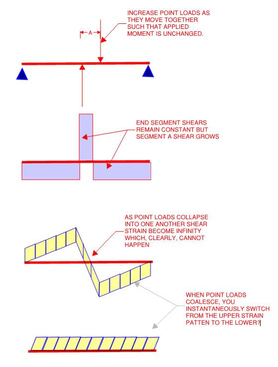

That's interesting BA. I'll suggest a refinement as shown below whereby the point loads are not kept constant but, rather, increased as they come together to keep the applied moment constant. Some features of this arrangement:
1) The strain pattern would flip from a vertical shear strain to a horizontal shear strain once the loads coalesce. Like a singularity.
2) Given that this implies that the point loads, and the mid region shear strains, would become infinite as "A" shrinks to zero, the approach doesn't represent a real condition that would satisfy other material constraints.
3) There can't actually be such a thing as a truly concentrated moment that is the product of a vertical force couple. Any true concentrated moment requires a horizontal force couple and consideration of member depth.
This may be true when the concentrated moment is in the span, but getting back to the OP, suppose you add a cantilever of length 'A' to the end of the beam with gravity load P at the end. The moment is P*A at the support. From the perspective of the unloaded span, how does this moment differ from a concentrated moment applied at the end? The reactions are P(L+A)/L and P*A/L and the shear is P*A/L across the unloaded span and there is no horizontal force couple.
Or are you saying that the bending stresses at the support create a horizontal couple?
I have to admit that I am having trouble seeing why the slope of the unloaded span (according to theory) has a value other than zero when we know it should be zero...very frustrating.
