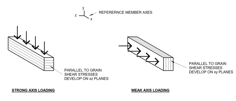

If you refer to the diagram below, I'm showing example surfaces where I think the shear stress parallel to grain is developing on the member under both loading cases. Does the fact that one happens on xy planes and one on xz planes help anything or are those parallel to grain shear stresses still additive?
To my eyes they aren't additive per se, but they do combine (perhaps in an additive sense) at the exact center of the member, which is a line along the length of the member..... I hesitate to dismiss this as "it's so esoteric it probably never happens in reality" but it's a bit tempting. What are the stresses we are dealing with? I mean if we come up with a (novel?) stress check that doesn't apply and the section passes, well, it sounds safe, if we come up with a stress check that's in the code, that's at least orbiting the standard of care, if not hitting it.

MJC6125 - your image depicts my number and one and number two points from above perfectly. Depending upon how the log was sawn (quarter, rift, rift and quarter, plain) and where the stick came from in the log, you could have grain at a number of angles to the axes of the member. The worst case for single axis bending are the two you show (though the weak axis case is pretty rare for most commercially milled lumber.)
My point three needs a slight revision - 45 degrees isn't the case of concern. It's the angle that corresponds to the peak combination of the two stresses. It's only 45 degrees if the shear stress from both are equal. But that doesn't change anything - the math is still right. Just makes the description make sense!

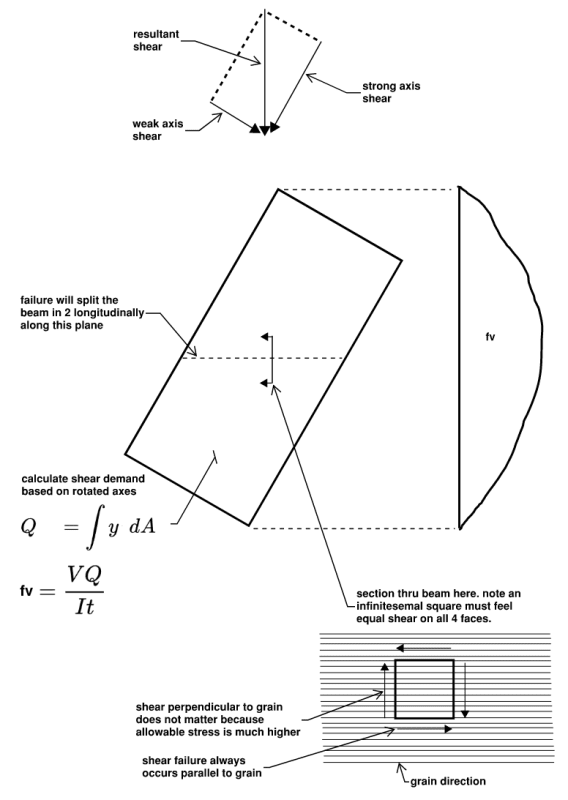

I think the two shears only coincide on a point in the center of the cross section. If that section "fails" you develop a kind of diamond shaped area which is larger than the point and it stabilizes. It would also only occur where the two stresses are maximum, so it's over a limited length on the cross section. Steel gets more into combined stresses, I'd be tempted to look at the AISC spec and see if they have anything about combined shear stresses from biaxial bending, but you're dealing with a ductile material there, so if you don't find anything that's maybe not "proof" there isn't a potential overstress. The old ASCE LRFD for wood construction might be worth a scan as well.
Brian, not sure I agree on the diamond failure mechanism. how does the beam know it's being loaded along 2 axes?
phameng, not sure I follow your sketch, isn't max shear at center?
this sketch shows what I think would be the most precise way to calculate your demand. as far as what code addition I would propose, some variation on summing shears was suggested by like fifteen thousand people above and I think that would be a fine approximation.
Mike Mike - you're right. I had it correct the first time. I put the good one back. I forgot what Q meant, apparently.
I think it's important to note that the failure will occur on that plane only if it coincides with the plane of the grain at the same point. The likelihood of that happening is probably even less than single axle shear failure plane coinciding with the grain (which is actually pretty common in quarter sawn lumber bent about its major axis), leading to very infrequent failures and an assumption that it can be ignored.

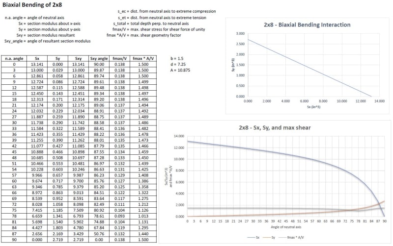

I investigated both a 2x8 and 8x8 beam in biaxial bending and shear:
[URL unfurl="true"]https://res.cloudinary.com/engineering-com/image/upload/v1699550010/tips/Biaxial_Bending_and_Shear_Investigation_-_2x8_and_8x8_-_2023-11-09_sxf03s.pdf[/url]
To attempt to answer the OP's original question:
Suppose you were to load a 2x8 beam equally about both x and y axes, resulting in moments, Mx and My, of the same magnitude with the resultant moment, Mxy, at a 45 degree angle. Since the moments are equal, the section moduli, Sx and Sy, are also equal. From the 2x8 graph above, the point where Sx and Sy are equal (and intersect) is roughly at a neutral axis angle of 87 degrees (note that this is not at 45 degrees due to the slender section). Now, if the corresponding shear forces, Vx and Vy also happened to be equal, then the resultant shear force, Vxy, would be 1.414Vx. If you were to look at each shear force independently, you would find (see the chart) that fx_max = 0.138Vx and fy_max = 0.138Vx. You would also find that fxy_max = 0.132(1.414Vx) = 0.187Vx. So, in this particular case, the resultant shear force, Vxy, produces a greater shear stress than the individual components of that force, Vx and Vy.
Perhaps the codes have overlooked this. Although, I think a slender member (like a 2x8) is unlikely to be loaded equally in both the strong and weak directions anyway, and even if it was, it would likely fail in bending first. There probably aren't many likely scenarios where the shear failure would control over a bending failure. Perhaps a large concentrated load applied near a support would be one.

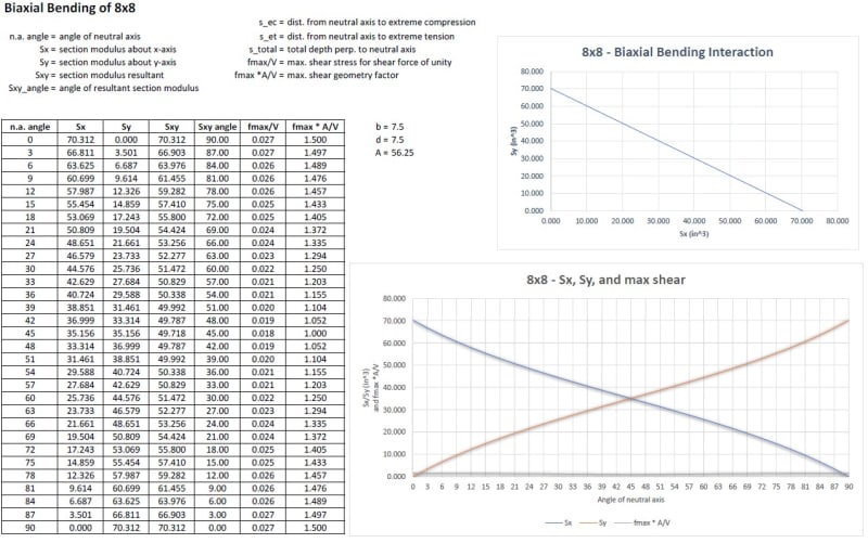

For the 8x8 beam above, it's interesting to note that if the same loading scenario is investigated as for the 2x8, it's found that the resultant shear force, Vxy, does not produce a greater shear stress than the individual components of that force, Vx and Vy. The difference here is that the 8x8 section is not slender, and in fact, at a 45 degree angle, the max shear stress is only 2/3 of the max in either of the orthogonal directions.
It can be observed that for a rectangular section, with width b and depth d:
[ol 1]
[li]If the neutral axis is oriented perpendicular or parallel to the sides, fmax = 1.5 * V / bd[/li]
[li]If the neutral axis is oriented passing through the diagonal, fmax = 1.0 * V / bd[/li]
[/ol]
In the graphs above, at the angles where the neutral axis passes through the member diagonal, the term that I refer to as the geometry/shape factor (fmax*A/V) is equal to 1.
Finally, as a conservative approach, I think it's reasonable to calculate the resultant shear force, Vxy, from the individual components, Vx and Vy, and then, assuming a rectangular section, calculate the max. shear stress as fmax = 1.5 * V / bd. As discussed above, using this approach could be conservative by 50 percent.
There is also a practical consideration here. We could sharpen our pencils to the nth degree with complex theoretical analysis methods. But the end of the day, we will still be comparing those applied stresses to allowable stresses that have been derived by statistical methods for natural materials that are graded by humans and that have natural imperfections.
The allowable stresses are based on the code prescription that they will be compared with 1.5 * V / A. It's all an attempt to account for shear stress distribution in a non-isotropic material. It's an educated best guess at quantifying something that is hard to quantify. Fortunately, the current code provisions and allowable values appear to have been serving the purpose of protecting life safety pretty well. Can't think of the last time I heard of a catastrophic failure in shear in dimension lumber.
