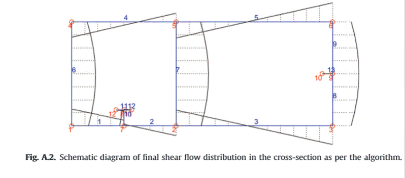

I believe there to be a subtle difference between my understanding and CANPRO's understanding on this. In steveh49's sketches, I believe that there will indeed be shear flow at (A,C,E). It's just that those shear flows are redundant from the perspective of enforcing a common strain profile upon the assembly. We could forgo those connections and still create composite behaviour but, once in place, I expect that they will draw horizontal shear
I can't upload sketches at present. If somebody does the shear flow diagram on steveh49's three web thing, I suspect that would clear things up. The zero shear locations should be in the flanges, somewhere between the webs I think.
I agree with KootK. In the other topic, there were statements that the shear flow is not necessary. However, if you don't size the welds for the elastic solution, you'll yield the welds, potnetially at low load. I prefer to avoid that.
Here's the shear flow distribution for a two-cell section from the literature.
Well, it turns out that shear flow in multi-cell cross-sections is too complex for a simple VQ/IT and too complex for this simple engineer.
I believe that the simple VQ/IT fails us here. You can apply this equation where the webs meet the flange and it is clear that flanges are "supplied with bending stress" from the three webs, so the point of no shear flow must be between the two webs - I get that now. But if you were to apply the simple VQ/IT formula at point A (ref steveh49's sketch) or anywhere else along the flanges, the value Q comes from the bit of C-shape left over and is equal to zero, which is contrary to what is happening in reality.
See this link which seems to provide the theoretical background to steveh49's last post. There is an identical shear flow diagram on page 36 of the PDF. I don't have it in me right now (or probably ever unless I have to) to sort through the math and see where the simple VQ/IT becomes incorrect.
Apologies to anyone I may have offended in this or the previous thread. It seems I was wrong about the original condition with the 36" vertical plate and two C15 channels - that forms a multi-cell closed section and does in fact develop shear flow in the welds.
CANPRO, if the system has some ductility, you can cut the section into single-web elements that each have their centroid at the same level as the composite section. Equal flange width if the thicknesses don't vary. It's not correct but close enough, hence the ductility proviso. Probably close enough for the safety factor to avoid yield at service load.
One method to do it properly is to cut each cell once so there are no closed cells. Start from zero shear flow at the cut, work out how the result is wrong (not in equilibrium), apply equal-opposite shear flow to restore equilibrium. I wouldn't do this personally; I'd get a keen young engineer to do the hard yards if this were ever necessary.
Edit: Canpro's doc says you have to use compatibility to work out the shear flow, not equilibrium. Even worse. Definitely a task to delegate.
