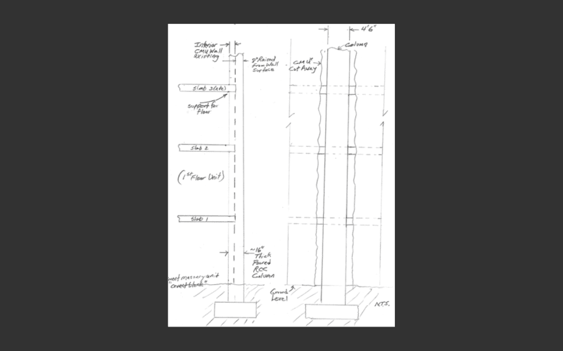

In order to improve shear punching without interior drop panels, would construction of a column on an outside end wall (shown below) of a multi-story building be doable? Walls are 8" CMU sitting on the slab. Removing the CMU at each level gives access to the edge of the floor slab. Adding the column decreases shear/moments on adjacent columns which have shear punching issue. Incrementally forming and pouring the concrete to create the column and getting concrete under the slab at each level may be the challenge. Thoughts?
I'm not convinced there's an awesome solution to dealing with this issue, "anything" could work and if it's done reasonably founded in principles of mechanics, it won't make it worse, it feels like someone's Plan B Master's project, honestly.
Are you intending the column and footing to be "cut in" to the structure , so this column going to be floor-by-floor inserted with the slab concrete continuous through the slab-column joint? I suppose settlement could influence things, but you should still get some force transfer "at ultimate". Maybe the "nonshrink" grout could be an element, (it expands then shrinks resulting in more-or-less zero shrinkage). If you could get enough of a shelf, or even insert a beam on the edge it seems like you could transfer force/load into the new columns and relieve some of the load at the adjacent columns in a rational way.
Alternately, what about some steel angles that are epoxy bolted a bit down the existing column, then that portion above it is filled with concrete and some reinforcing bars to transfer the load in bearing and expand the b0 perimeter in the punching shear calculations at the existing columns? Ugly, perhaps, but safe(r)? How much added perimeter would you need to get the existing column-slab joint to work?
Live load reduction will probably not do any good, plus the square footage and the fact that I don't think slabs are even listed for live load reduction....
What about actual strength of the as-built concrete? Sometimes the concrete is stronger (or weaker), maybe some testing? Would another 50 psi concrete strength get you a "pass" under the original code? (Not that that's what you are actually after, I guess).
Yes, the column will have to be "cut in" to the existing CMU wall. Sounds like you think it is feasible, just tricky at high elevations. Feasibility is what I'm after. The existing b0 is 66 inches for an 8x36 inch column and the demand/capacity ratio is above 2. It would take adding 5.5 ft to long axis of column to pass the SP calculation or adding 8 inch of thickness of concrete extending out in the critical perimeter region. Having 500 psi extra concrete strength doesn't improve things that much. Definitely a Master's project.

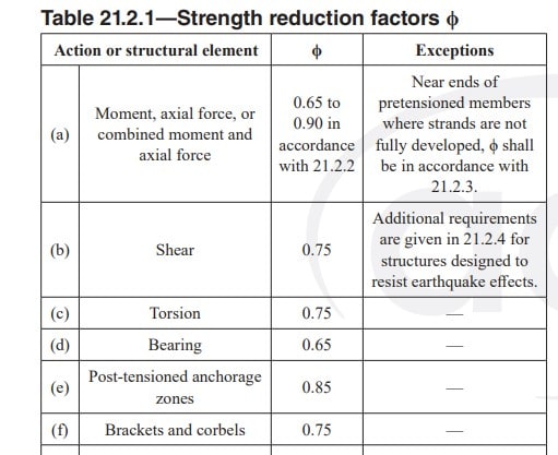

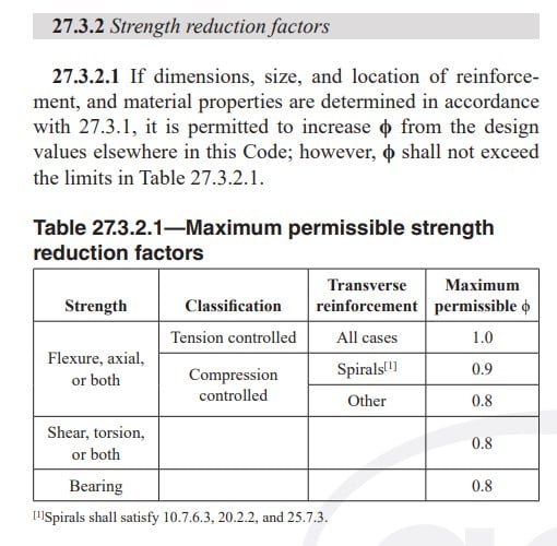

Side note: Are you looking at the existing via Chapter 27? They allow larger phi factors than during design, if it's based on measurements of as-built conditions?
I'll checkout out, but it seems that its missing limit by too much for a small factor adjustment.
It's worth noting, mostly for the "next one" as going from 200% overstress to 190% overstress won't really do much. If you can get more on the existing strength it might help somewhat, as it all contributes.
I thought you were working with a PT slab. As I recall a lot of reductions are taken for relaxing of the strands, is there any chance you can measure the PT tendon stress and get more N for the shear force? Now that I look at it, it isn't glaringly obvious there's any increase allowed for PT anchorage, although if this is at a column it's probably not an anchorage, except you said it was at the corner of the slab. It gives an increase for shear (0.75 to 0.80)
The increase in strength reduction factor to 0.8 is helpful. The column is on an end wall so ACI refers to it as an edge column. The code does not seem to give any procedures for taking advantage of post tensioning for the shear punching calculations. I guess they assume the positioning of the tendons coming through a column are not effective or reliable in producing shear stresses on the full cross section. The post tensioning would act on the concrete x-section in a direction opposite the gravity load, which would be very helpful. Is there anything in the code that would allow such a treatment?
