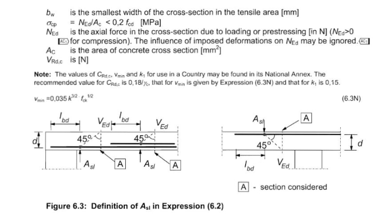

The equation for shear strength of a RC section without shear reinforcement in the various codes takes into account the ratio of longitudinal reinforcement "in tension", which acts as a crack width limiting factor or through dowel action to aid in shear strength.
Example from EN1992-1-1:
The shear strength is analyzed by means of the truss analogy, which in the general case of flexure works with the uncracked section of concrete above the neutral axis in compression. One question is, what happens when the section is fully in tension and the neutral axis is outside of the section? The code formulas seem to be able to be calculated even with tension as axial force, although this doesn't seem very convincing (in the case of EN1992-1-1, it is possible to break the equation with too much tension and get to absurdly low strength, which would yield orders of magnitude different results with another code).
And my main question, which reinforcement should be plugged in the equation as the reinforcement "in tension"? Take the general case of a beam in tension with As,top << As,bot. It is evident that the strain in the reinforcements will also satisfy εs,top >> εs,bot, implying that cracking will be substantially worse in the top side. Would that be a clue that the top reinforcement should be plugged in the equation, no matter the sign of flexure?

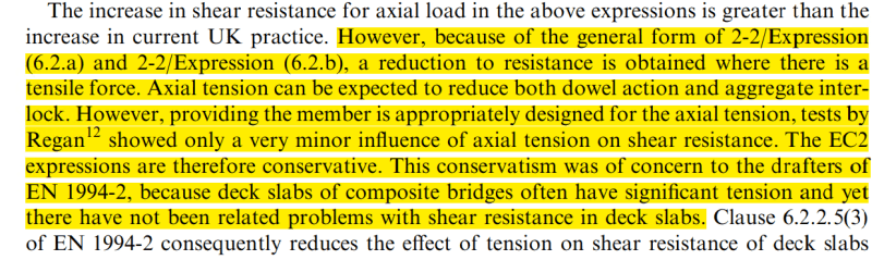

The code actually intends to have shear strength for members in tension as explained in the designer's guide:
HTURKAK said:
- AFAIK , the equation 6.2 has essentially been derived for beams, failing in shear flexure. When the RC member experience full tension , in this case the axial stress ( σcp ) will be negative . One can easily see the expression 6.2 will be zero if the term in parenthesis is zero.
It was derived for beams but also used for slabs and columns which can lead to inconsistencies in some cases. In the case of tension, the expression will not necessarily be zero, depending on the value of σcp it might only reduce the result.
My question mainly was, which reinforcement should be plugged in the equation? Seemingly from the theory of shear with the truss analogy it shouldn't even work for members fully in tension, but the code is inconsistent and intends for such members to have a calculatable shear strength. A bridge deck composite slab for example would always have to be provided with shear reinforcement if shear strength should be 0 when the section is in tension.
