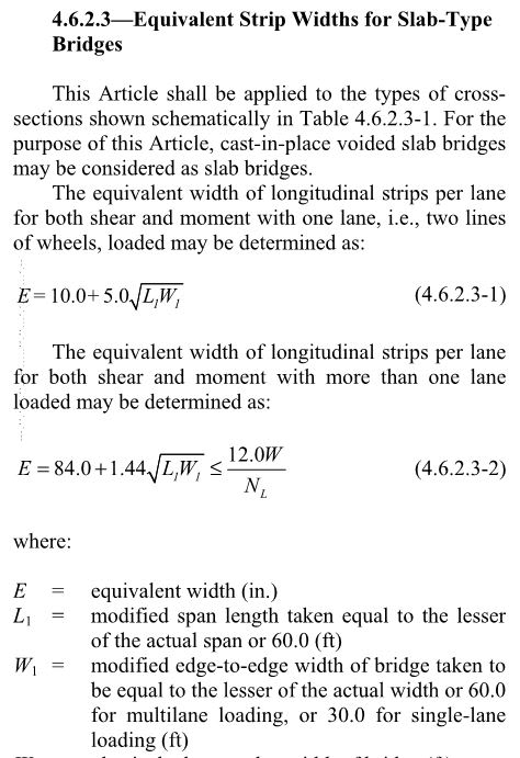

Here is the AASHTO for slab type bridges because it pretty generous on the equivalent strip width.
Yeah, AASHTO is kind of how I am justifying it in my mind. A I alluded to in my OP: you can model a lot of loads on slabs with the thicknesses they prescribe and not get acceptable shear stresses until you have eaten well more than half of the failure plane.
But by that approach, you need distribution steel perpendicular to the main steel.
Agreed, you should have distribution steel. AASHTO gives specific guidelines but ACI seems to hint at that when it says "based on the extent of the slab that can be assumed to act as a unit in resisting internal forces"
The only reason I wouldn't want to use AASHTO as more than just a rough check is slab bridges per AASHTO have specific distribution reinforcement requirements that are much higher than the equivalent in typical building slabs IIRC.
