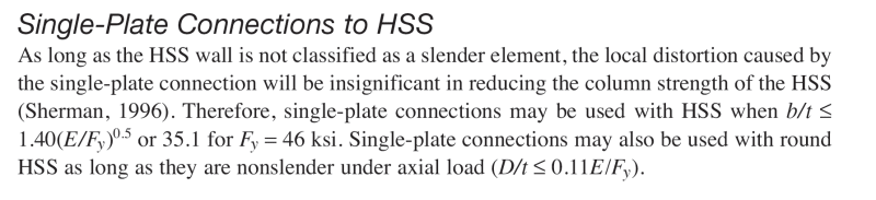

Can anyone point me to a paper with the solution of a shear tab connected to a rectangular HSS or have a solution to this? Thanks...

The picture that you have posted is O.K. Provided that the fin plate ( or shear tab) yields before punching shear of supporting member. Check for local shear and punching .. if not satisfied , strengthen the conn. ( e.g. slot both faces and extend the fin plate to other web also )

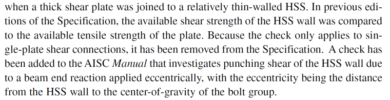

For reasons unknown to me, AISC renovated Chapter K of the specification in 360-16. From the commentary on K2.3:
AISC 360-16 Comm. K2.3 said:
Over a wide range of connections tested, only one limit state was identified for the rectangular HSS column: punching shear failure related to end rotation of the beam, when a thick shear plate was joined to a relatively thin-walled HSS. In previous editions of the Specification, the available shear strength of the HSS wall was compared to the available tensile strength of the plate. Because the check only applies to single-plate shear connections, it has been removed from the Specification. A check has been added to the AISC Manual that investigates punching shear of the HSS wall due to a beam end reaction applied eccentrically, with the eccentricity being the distance from the HSS wall to the center-of-gravity of the bolt group.
This check is in Part 9 of the manual (Design of Connecting Elements), and is on pages 9-14 through 9-17 in the 2nd printing.
15th edition of the manual. Pg 10-153. Section: "Single-Plate Connection to HSS" Equation 10-7a/b.
That's what you're looking for.
