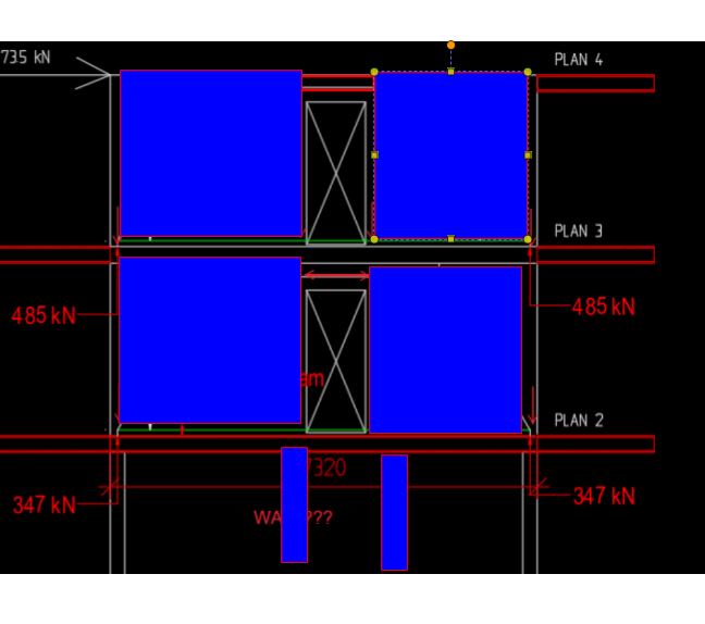

Hello everyone,
I am working on design of precast shear walls that have a system as shown in the Figure 2. The system was subtracted from the whole model as shown in Figure 1. SWT beams on Plan 2 (steel beams with an opened top for casting in concrete, Figure 4) will not carry vertical loads from the walls. The vertical loads are planned to go the columns heads through strut and tie model and reinforcement that serves as ties will be placed in the wall under the door. Which mean the beam will not be integrated to the wall for vertical load carrying purpose.
However, accumulated shear force at the base of the lower wall shall be transferred to wind bracers on the outer facads through hollow cored slabs carried by the SWT beam. Which mean the base of the wall need to to be connected to the beam anyway to transfer horizontal force to hollow core slabs.
I have lookup and found a simplified loading system for designing coupled shear walls, Figure 3 and it shows overturning moments at the base of the walls (M1 and M2). At this point I feel really confused. How should I take care of M1 and M2 when the wall and the beam are not integrated for vertical load? Especially for M2, it creates tension of right edge of the door, how can I neutralize that tension when my compression force is already directed to the column head through a diagonal strut. Please find attached the file containing figures stated above.
Thank you so much in advance for any suggestion.

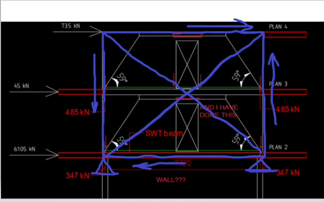

Some comments...
way back, when I first started I did a bunch of medium rises (20 storeys)with shear walls and corridor opening in reinforced concrete. There were several ACI articles by Rico Rossman (sp?) on coupled shear walls... before the advent of personal computers... solutions in non-linear, non-homogeneous differential equations (couldn't do them now; I'm way too old)... I've often treated shear walls as providing reactions only at the corners/edge.
If no wall at lower level then your columns have to be much wider... but can be accommodated using the same point load approach.

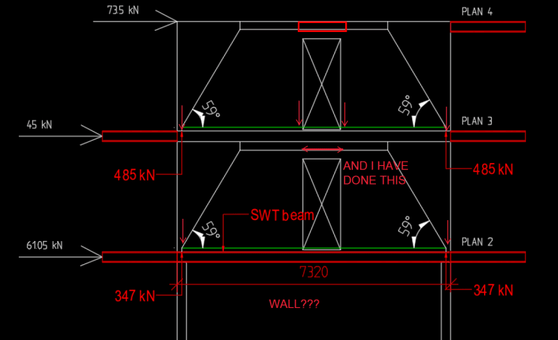

Hi Dik,
There is no wall under SWT beam. Accumulated base shear force on Plan 2 shall be transferred to outer facads wind bracers through hollow core slabs. Looking at your sketch, I don't understand why we have compression force on each door edge on Plan 3. Could you explain that that a little more? Thank you.

I'm going to abstain on the details until we have some kind of system that isn't missing important load path bits. The least invasive way that I can think to get you back to something plausible is shown below with a couple of columns inserted in the lower floor to resolve overturning in your walls. Your coupling beam idea does, in fact, create a valid load path. I just don't see it being stiff enough to be worthy of serious consideration.

Occasionally, I've used the compressive forces to reduce/eliminate the point loads on the interior of the span. As far as resisting the shear; this can be accomplished via steel sections (have to watch deflections, though) with the beam connected to the precast shear wall... not too difficult even for large forces with steel. I've done many precast and masonry shear walls, where the precast beam (for masonry, too)over the corridor is only a 8" deep with the space between the HS slabs concrete filled acting compositely with the beam to give an equivalent depth 8" deeper than the precast beam, with single leg stirrups transferring the shear.

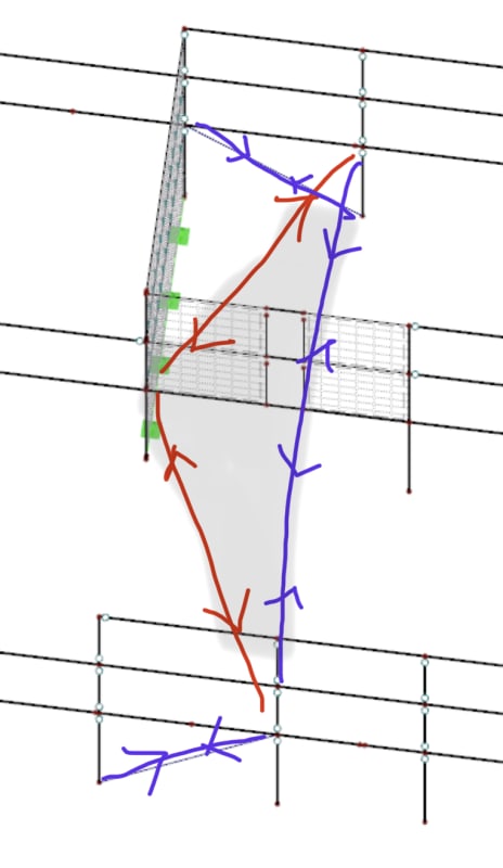

Is this the intended lateral load path, diaphragm action to transfer the horizontal kick from the base of the shear wall out to the perimeter braces? See crappy phone markup below...

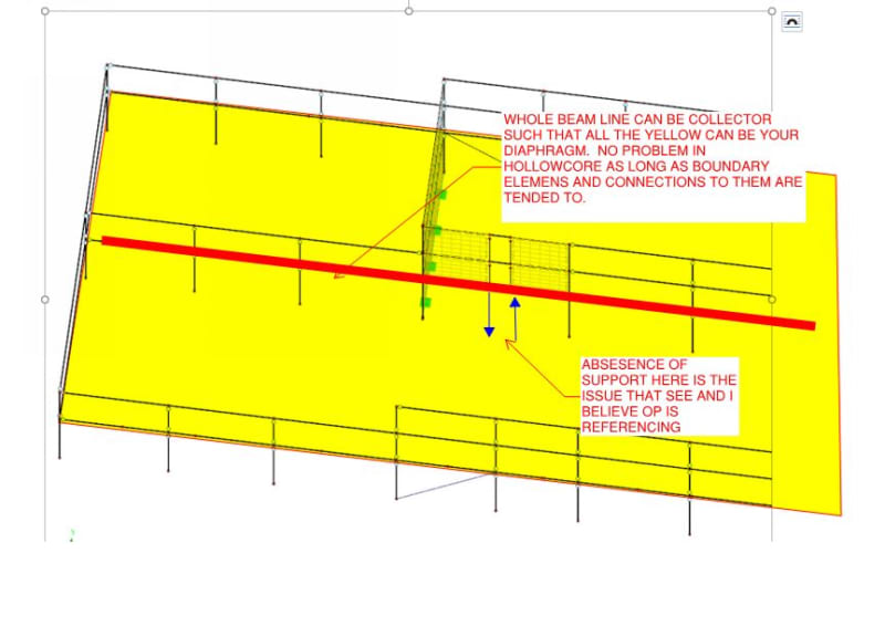

It could work in theory I guess. Not ideal by any means and you’ll no doubt have second order effects to consider as the whole thing is just not stiff enough for me - but could be done I guess. How you justify that diaphragm action from the hollowcore (presumably with reinforced structural topping??) is a different matter. You might consider a horizontal wind girder beneath the floorplate?
Hi MIStructE_IRE,
Your sketch shows the intended load path and that is correct that the diaphragm action contributed by reinforce topping over hollow core slab. I am not really the one designing the slab. It was my project manager but what he explained looks like your sketch. It is another engineering contractor who does the foundation. I have to take a look if they have wind girders beneath the foot plates but I assumed that they have that once they see the presence of diagonal wind braces.
I expect that there's quite a bit of diphragm available to get the lateral transfer done, even if the though roof is not hollow core.
