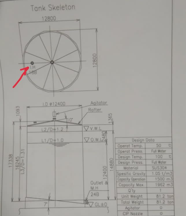

Good day, Engineers!
For example, I already designed the tank with 1 foot method and Annex V at API 650. The thickness are 12mm, 10mm, 8mm, and 8mm. The tank has roof frame without column and has agitator at the center. Is there any other computation for additional thickness for shell plates or to check if the shell plates can carry the vertical loads like roof frame without column, and an agitator at the center.
Thank you, Engineers! God bless.
And this has vent. Agitator weight is 5tons also.

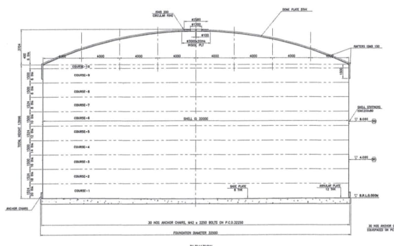

This is a rafters for dome. But this is for reference only. I'm design for cone roof.
As you can see, there vertical I section outside the tank shell.
I already design roof framing for steel tank and it is locate inside the tank.
But now, it is stainless steel tank. The client wants the roof framing is outside the roof shell.
I'd also worry about sliding down the slope.
My boss told me that it should be anchored. Maybe because it has slopped bottom.
Now you can see. API 650 doesn't have section or provision about agitator and slopped bottom.
Any ideas and suggestions are really appreciated.
Thank you.

Pls find below my notes,
i= For the tank without vent ; the internal pressure ( vacuum ) shall be calculated acc. to piping arrangement and valves ..The absence of vent does not mean the vacuum pressure 6.9 kPa will develop.. The probable vacuum pressure shall be calculated considering the emptying and filling ..
ii= The sloped bottom ; the sliding shall be checked together with applicable seismic and wind loading.. and FS suggested in the code shall be provided.If necessary, provide anchorage for sliding and overturning.
iii= The radial rafters seems to be above the roof plate.. API does not address the use of supporting system above the roof plates..
iv= You are expected to comply roof to shell joint ( compression ring ) requirements for self supported dome or cone roofs..The horizontal and vertical force flow from radial rafters to compression ring and to the shell shall be justified..
v= data provided on the dwg does not give info. for the wind, seismicity, type of content..
Good luck..

Internal and external pressures are not calculated during the tank design - they are usually given to you. It's like Gravity, atmospheric pressure, soil bearing capacty, solar heat input, insulation R-value, snow load or seismic parameters - they are things dictated to you from the environment, the customer, the process, the location, materials, etc. Choosing an arbitrary external pressure (vacuum) in the absence of a real load condition will make your tank stronger, but for no defined or required purpose other than an added safety factor for resisting that particular imaginary load condition.
Also, Annex V is not for wind loads. It is for internal vacuum represented as external pressure. Other sections of the basic standard cover wind buckling and overturning.

Can you check again the 2nd photo I sent. That I.H 18B, is that a vent Sir?

The sliding and OT check is required as per app. E.7.6 and 5.11 . Regarding the tank with sloped bottom, the slope will have negative impact for sliding..
The compression ring req. is stated at 5.10.5.2 for self supporting cone roofs. Although external radial rafters provided, the roof still self supported ..moreover, the radial rafters more complicate the tension ring required.
Wind velocity 290 kph is too high...could be syclonic region ? You are attempting to design the the tank and still you do know the content ?
Apparently there is a roof nozzle and could not be interpreted as a roof vent.
