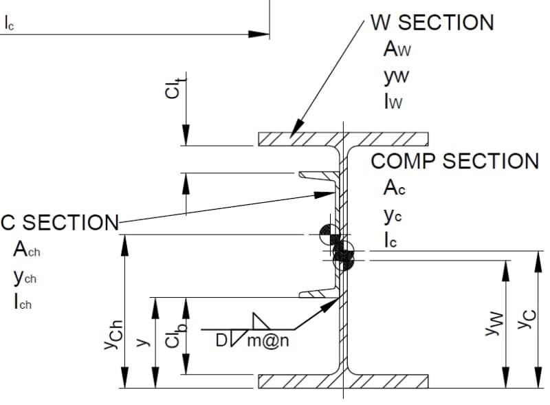

I just enjoy the work... sometimes a bit challenging, and in the last 3 years I've written about 850 SMath programs to help. The latest issue is where the EOR wants the steel fabricator to CJP weld a C section to an existing W section (not spec'd as such)... about 200' by two sides of a building. I'm just doing up an SMath program to accommodate it... I still need the loading from the EOR... The clearance top and bottom is just to check for adequate space to get in to weld... about 3"
