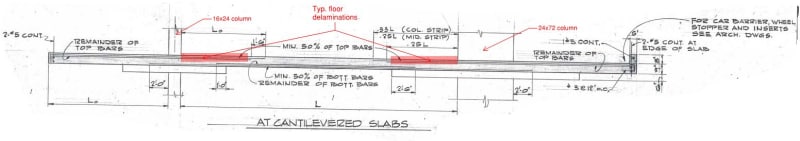

Hello,
Looking for some out of the box ideas for this unique situation.
I am working on restoring the slab of a concrete framed parking facility of a high-rise residential building. It is a two-way slab with three bays in one direction, and 10 bays in the other direction. In the direction of the 3-bays, the two end bays are cantilevered. I encountered significant concrete delaminations along the column strips, top of slab, nearby the columns where the top steel should be developing. This situation occurs at various column strips throughout the structure, and also occurs at the same location on multiple levels. The parking facility is 9 levels. My worry is that during construction, the vibration for the chipping hammers will loosen up any bond that is left in the bars enough that it may cause a potential failure.

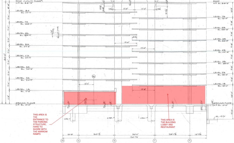

The ground level of the structure is a restaurant and a lobby space so shoring down to the slab on grade is not feasible. Traditional shoring down two levels to share the dead/live load of a particular level with other levels below is also not feasible everywhere as there are stretches that have delaminated concrete at a particular column strip at several levels below.
I have been contemplating a few options, the options I've thought about include:
1) Developing a triangular bracing frame to support the cantilevered slab and anchoring the frame to the column (could be costly if this has to be done at dozens of locations).
2) "Tying" all cantilevered slabs with post-tensioned cable so that they all react together. I am unsure about this one because although the slabs currently holds up to the service level dead and live loads, how can I prove that they will all act in unison to resist a slab that is trying to collapse if I don't know how much capacity I have left?
3) On a particular level (lowest preferred), drill through the column in the direction of the cantilever span, install reinforcement through the column and out to the cantilever, and cast a concrete wall. This would essentially create a very deep beam and transfer the loads to the column. The levels above the wall could then be shored traditionally.
I would like to hear if any of you have encountered this problem and how you resolved it. Or if you haven't encountered it, but you have some thoughts, that would be great as well. Thank you!

The structure is conventionally reinforced, two-way slab with drop panels. In the E-W direction (direction of the cantilevered slab) the reinforcement is typically laid out as one would expect a 2-way slab (column strips and middle strips). In the other direction, the reinforcement is actually evenly distributed. Off the top of my head, the cantilever spans approximately 2/3 of a vehicle length (10 feet) and only top steel is present. The center span is nearly 25 feet. I can confirm these tomorrow morning.
The structure is enclosed, but it is exposed to chlorides as vehicles bring in the road salts. The structure has been repaired in the past but it has likely been a decade since its last restoration effort; hence it is experiencing concrete delamination from corrosion of the top steel reinforcement in the E-W direction (cantilevers).
As I mentioned previously, the concern is on top steel debonding, which can also lead to some punching shear failures as well. Typically we observe delaminations behind the column at about the last 2-3 feet where the column strip top steel should be bonded and developing.
The ideal solution would be to implement a way that I would be able to set up shoring on the lower level (let's say between Levels 1 and 2 since ground level is inaccessible), then use that stable/supported slab to share/distribute the load on whatever floor the contractor is repairing immediately above.
Maybe something like the attached could work. Kind of a typical shoring/re-shoring setup but with the addition of steel beams flat on the slab so the questionable slab doesn't have to do as much work.
CANPRO, that is an interesting layout, it would block a portion of the drive lanes but it may be manageable. My only concern with that design is that the span on the left hand side of your drawing would be reacting against a slab that does not have too much top steel to take care of the bending moment from the post shores. Below are images of the framing.
