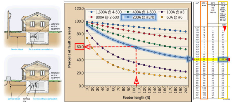

The SC at the transformer bushing is significant damped by the LV service entrance feeder impedance. The standard practice of utility in the US is not to oversize distribution transformers for economic reason. Therefore, exceeding the SC in the US residential service at the interconnecting point it is an unusual event.
The majority of the residential services are single phase (split-phase) 120/240 volt system. The 240 V secondary winding is center-tapped and the center neutral wire grounded. Most service transformers are pole mounted a less quantity are pad mounted unit.
See below a typical SC damping effect on the service entrance feeder.
IS the wire shown CU or AL? My apologies.
The author used Cu to develop the graphic above.

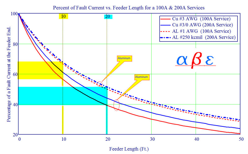

Below is another approximate curve for a single phase residential service 120-240 Volts based in 25kVA & 50 kVA with 1.4% and 1.8% impedances respectively.
The SC provided by pole mounted transformers is usually lower for the same kVA capacity since those transformers have larger impedances than the pad mounted units.
CORRECTION: The solid lines on the graphic above are for copper conductors.
Thank you! This graph is worthy of a "sticky" :)
Cucky, have you tried the new edit feature?
You may be able to correct the graph.

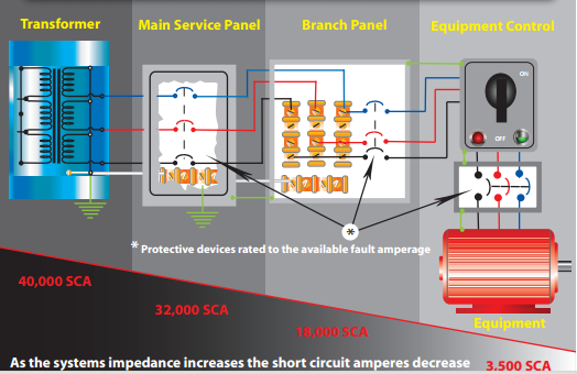

can someone clarify why short circuit current rating getting decreased like this?
At the transformer the transformer impedance limits the fault current.
At the service the impedance of the service conductors plus the transformer impedance limits the fault current.
At the branch panel the impedance of the branch circuit conductors plus the impedance of the service conductors plus the transformer impedance limits the fault current.
etc.
