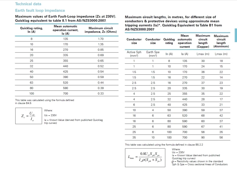

For each size breaker, list the maximum circuit impedance based on 120 Volts.
eg: 20 Amp breaker, use a minimum of 300 Amps.
120V / 300A = 0.4 Ohms maximum circuit resistance for a 20 Amp breaker at 120 Volts.

For number two- I want to take the whole system into consideration. At least that is how its done in BS7671...
Consider a ball field lighting application behind a school or college. There may be a 60, 125, 225 or 400 amp feeder going for some distance to a food service hut before the final branch circuit leaves that. Or a farm house to a work shop going beyond. Or a 60 amp life safety feeder going up 10 stories to a pent house panel in a plus sized building... yes I've seen prints asking for #6 on that one... no-no in my book.
Total Z I think is key.
Zs=Ze+(R1+R2)

Table similar to this one?

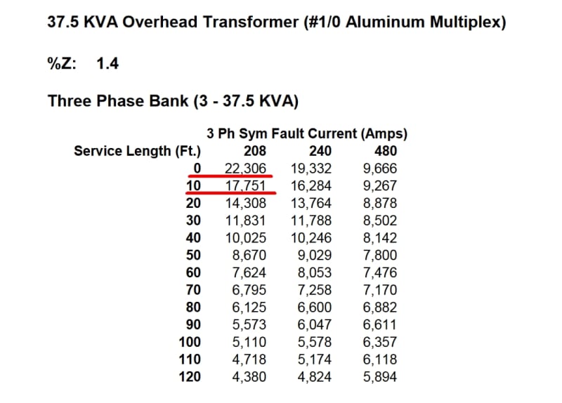

As I understand, you want or have a table to show minimum cable lengths to drop the ASCC to match the switchgear capability.
You also want a table showing the maximum cable length to unsure reliable tripping of branch circuit breakers.
In the one case you want to show a minimum cable length for currents in the order of tens of thousands of Amps on the main service conductors.
In the other case you want to show the maximum cable length for currents in the order of a few hundreds of Amps on the branch circuit conductors.
I would handle this as two distinct and separate issues.
You may combine the recommendations in one table.
I would use two tables.
Yes- that is my goal.
