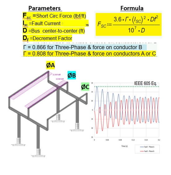

Hello,
I am wondering how to compute the short circuit force that would be exerted on (3) aluminum bus bars within a 3 phase transformer. Here are the specs:
2750 kVA 3 phase transformer
HV voltage is 13200Y/7620
LV voltage is 600 Delta
LV current is 1528A
(3) LV bushings on right side of transformer
# of bus bars = 3
Bus bar dimensions are : 42.5" long x 6.00" wide x 0.5" thk
I would use Inventor to simulate the force of stabilizing stiffeners to see if I need to see if a change to the stiffener shape is needed.
Electromagnetic or from thermal expansion?
For this study it would be electromagnetic.

"....I am wondering how to compute the short circuit force that would be exerted on (3) aluminum bus bars within a 3 phase transformer....Bus bar dimensions are : 42.5" long x 6.00" wide x 0.5" thk..."
1. The basic data needed to calculate the maximum force appearing on any phase resulting from a fully offset asymmetrical peak current:
a) is proportional to the current square ( I2), and
b)is inversely proportional to the spacing distances of the centre-line between phases. Note: Please clarify 3bars per phase or 1bar per phase.
2. For a) we can calculate the [short-circuit current] if you can furnish the percentage impedance (%Z), taken from the transformer name-plate.
For b) you have to take the measurement from the drawing or better from the actual site measurement.
3. We may be able to make some computation with abovementioned data.
Che Kuan Yau (Singapore)
Hello,
1. The %Z from the transformer nameplate is 5.85. There is (1) bus bar per phase.
2. The spacing between the each of the bus bars is 6.25" center to center.
Mr. kevc70 (Mechanical)(OP)16 Aug 23 05:35
There are numerous valuable advice by learned readers.
I am suggesting the following for your consideration. Please verify whether it make sense. Thank you.
My understanding the maximum on the center phase is
F = [8.66 x 2 x [I']2x 10-4]/s in (N/m).
= 8.66 x (68.22)/158 = 3.717 in (N/m)
Note: 1. the offset factor n is taken as 2.55,
2. Irms is taken 1528A/0.058 = 26,119.6 in (Arms),
3. s in mm 6.25 in = 158.75 mm,
4. the force[/b is independent of whether the bar is of copper or aluminum.

If transformer L.V. short-circuit it is ukr= 5.85%, the impedance will be:
ZT=ukr%/100*Urt^2/SrT where Urt=0.6 kV and SrT=2.75 MVA.
ZT=5.85/100*0.6^2/2.75=0.007658182 ohm
If the supply system impedance=0 then
Ik”=600/sqrt(3)/ 0.007658182/sqrt(3) =26115.86 A[rms] three-phase short-circuit.
Line-to-line short circuit
Ip2=sqrt(3)/2*Ik”= 22617 A[rms]
Ipeak=k*sqrt(2)*Ip2
Since we don’t know what is X/R of the transformer impedance we take the maximum k=2
Ipeak2=2*sqrt(2)*22617=63970.54 A
According to Schneider brochure no. 162 electrodynamic forces on busbars in LV systems:
F/lng = 2* 10-7* I1* I2 (k/d)
lng=42.5”= 1.0795 m
d=0.15875 m
If d/a=12.5 and b/a=12 k=0.87 [see the attached image]
k=0.87 vertical bars
F2=1.0795*2/10^7*63970.54^2*0.87/0.15875=4841.927 N
If we consider three-phase short-circuit then
Ipeak3=2*sqrt(2)*26115.86=73866.8 A and then
F3=1.0795*2/10^7*73866.8^2*0.87/0.15875=6455.9 N
 https://files.engineering.com/getfile.aspx?folder=206b2485-eafc-4693-96f4-0c570b8b07c5&file=Schneider_162_k_for_short-circuit.jpg

Here is some additional information for this transformer:
The insulating fluid is FR3.
The X/R ratio is 6.7
Total Secondary resistance is 0.12810E-02 @85C, and .10331E-02 @ 25C.
Step up transformer
65 degree average winding rise
KNAN cooling class
Where does the short circuit force physically act on the bus bars? The bus bars are each supported inside the transformer by (4)GPO-3 stiffener pieces that anchor the assembly to the LV bushings mounted near the bottom of the transformer. Is the force computed above (6455.9 N) acting on all (3) bus bars at once? Would it be possible to attach the force equation from the Schneider brochure?
Thanks to your new data and for the remark that my response was" so far" I remember I had no time to revise the calculation.
I found that calculating Ik" I divided twice by sqrt(3)
[see my post of 24 Aug 23 08:39]
Actually Ik"=600/sqrt(3)/ 0.007658182=45234 A
Revising the force calculation, introducing the last data and the waross remarks the result is 13276.3 N. [it is not 6455.9 N, I apologize].
No problem to attach some instructions from Schneider brochure.
However, I don't think you can finish the transformer design check based on our posts. The forum scope it is only as Engineer Tips only.
I was involved once in transformer design and I know the workshop practice is more detailed.
Some details are neglected, for instance-generator or system- impedance. Also, the voltage tolerance [what is the maximum supplied].
kevc70 said:
"Is the force computed above (6455.9 N) acting on all (3) bus bars at once? "
Of course not. I forgot to multiply by 0.866-as che12345 did.
I have not time to read all the posts-I am sorry-and it is not good.
