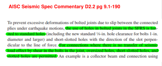

I am currently in the process of reviewing shop drawings for a very large warehouse type structure. The structure was designed in accordance with IBC 2015/AISC 14th edition. I located the LFRS (lateral force resisting system) around the perimeter of the building utilizing a concentric brace frame.
At the perimeter steel, the fabrication is calling for short slots in all of the beam to column connections. I would like to avoid this type of hole in these elements as these beams are acting as collectors for the brace frame system. Out of interest, I went digging into the AISC and they seem to allow for short slotted holes at the discretion of the EOR. The commentary has some discussion about why short slots are allows.... and shocker, it has to do with allowing for proper plumbing of the columns.
In this instance, where the perimeter beams are acting as a collector for the LFRS what are others doing? Are you allowing for short slots to be used in this instance? or do you insist on STD holes?
I'm not sure about your seismic requirements, but the AISC Seismic Specs do have some requirements. Otherwise, I don't know of any limitations on the topic.

I'd have to look it up, but don't short slots add very little travel in the direction of the slot? Like an extra 1/8"? This seems pretty small if you consider the way things move around in a major seismic event. The short slots may even serve to dissipate some energy and be better performers than 1/16" oversized holes.
Most of the time fabricators want to "torque" everything down, so under less-than-ultimate level forces you probably don't get any slippage in the joint at all.
To be clear, the connections are bearing type connections and not slip critical.
I understand the comments. The bolts are typically 3/4" making the short slots 13/16"x1"... so yes, if the bolts were centered perfectly you are looking at 1/8" per bolts (or 1/4" at every column). There are approximately 10-12 column per collector run... so we would be looking at a movement of approximately 3" over a length of 200' ish.
As of now, we are telling the fabricator to use 13/16" dia holes (standard holes) but I expect to get pushback sometime soon.

Usually I allow the use of short slots in collectors personally. IMO, it depends on the building construction, but for warehouse style construction (steel superstructure, metal deck diaphragm, metal cladding, etc), these structures are quite flexible-- any movement from bolt slip will not cause issues with the building envelope. The only other issue would be the potential for 'bolt banging' which is a serviceability issue (not one I've ever actually heard of happening however) not a strength issue.
I do think AISC is a bit unclear on if this practice is 'technically' allowed, as chapter J does say that slots are not permitted in the direction of loading which for collector loads that would be a violation of, but if you can reason to yourself that it is not adversely affecting the structural performance of the building and can accept the potential for additional movement I think it is a good way to help allow the erector some flexibility. For reference, PEMB structures use H/60 drift limit for a 10 year wind. These things can move alot more than you may think.

Sounds like standard holes are the way to go, then, unless the frame and cladding can handle the movement.
Yes, we have an overhang. The building is clad in insulated metal panel with outset 8" girts. We are using 14" columns and the architect wanted an extra 1" in there for good measure.... so 1'-4" to edge of foundation/angle.
We are going to specify STD holes for now and wait until the fabricator complains. They have complained about a lot of things already and we haven't even submitted our review for Zone 1 yet. Should be interesting.
