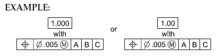

If I have 6 holes located by basic dimension that are of size .XXXX +/-.XXXX,
should the positional tolerance within the feature control frame also be at .XXXX?
ASME Y14.5-2009 was not clear.
The text in Y14.5-2009 para 2.3 seems to suggest they should be considered separately. I do not believe that there is any requirement they have the same number of decimal places.
One of the first practical examples in the standard fig 3-29 shows this, the 8X 7.9-8.1 dia is accompanied by a 0.14 position tolerance. Another fig 4-4 has a 69.93-69.87 dia accompanied by a 0.8 position tolerance.

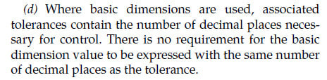

No requirement whatsoever for these to match.
You can get it from section 2.3.2 (d) on 2009 version
Season
To clarify the OP's question: We're talking about comparing the number of digits in the hole's size tolerance with the digits in the FCF. The standard is indeed clear about comparing the number digits in the basic dimension with the digits in the FCF, but that's different than what was asked.
With that in mind, I would agree with chez311.

I get this from James Meadows Textbook "Geometric Dimensioning and Tolerancing-Application, Analysis, & Measurement" page 15/16
Season

I was talking about a drawing in inches.
My 6X holes are .8782/.8764 Thru located with 3 place basic dimensions.
The positional tolerance attached to the hole size requested:
|[POS]|[DIA].0100|A|B|C|
|[POS]|[DIA].0010|A|
If 3 place basic dims used then this would be appropriate?
|[POS]|[DIA].010|A|B|C|
|[POS]|[DIA].001|A|
In other words I am not applying the positional tolerance to the "Hole Size"
but rather to the "Hole Location"
Thank you!
|[POS]|[DIA].001|A|
Yes. That will be appropriate, but so would 2 or 4 decimal places in the GD&T reference frame.
