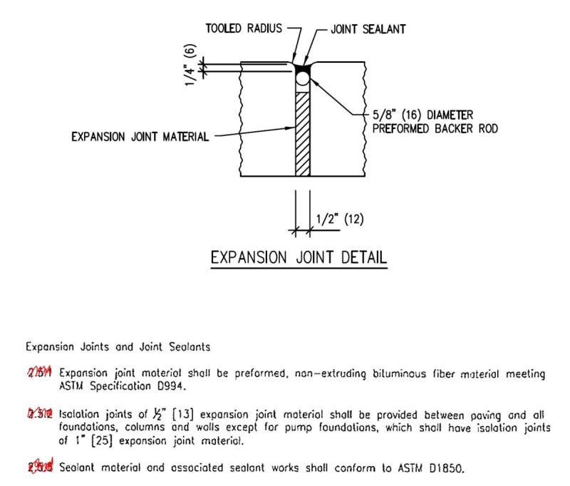

When I mentioned annular joint I was referring to the expansion joint gap that would occur between the pavement and the wet well walls. It's probably not that big of a deal since it's unlikely the site will be graded such that all the water collects at this location. You can always use a pour-in-place silicone like Dow Corning 902 silicone to seal the joint but that will only last about 5-10 years.
Don't forget to add trim bars with diagonals in the pavement around the wet well opening.
Well, it seems like you are saying water entering the joint location could be a critical problem. This project is located in a city prone to flooding, so this is beginning to be a concern to me.
I can talk to the lead civil engineer on the project about the drainage in this area, but I am concerned about water infiltrating the joint.
What do you mean by "Don't forget to add trim bars with diagonals in the pavement around the wet well opening"? Do you mean ACI's requirement for openings in concrete (i.e. like walls)?
I don't believe it to be a critical problem, but a detail that I try to take care of nonetheless. I try to avoid saturating the subgrade soils around structures if I can help it. More of a service level concern than an extreme event type concern. If this area floods, that joint is the least of your worries.

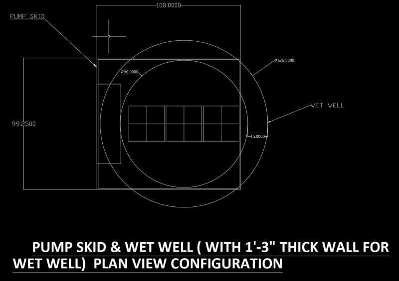

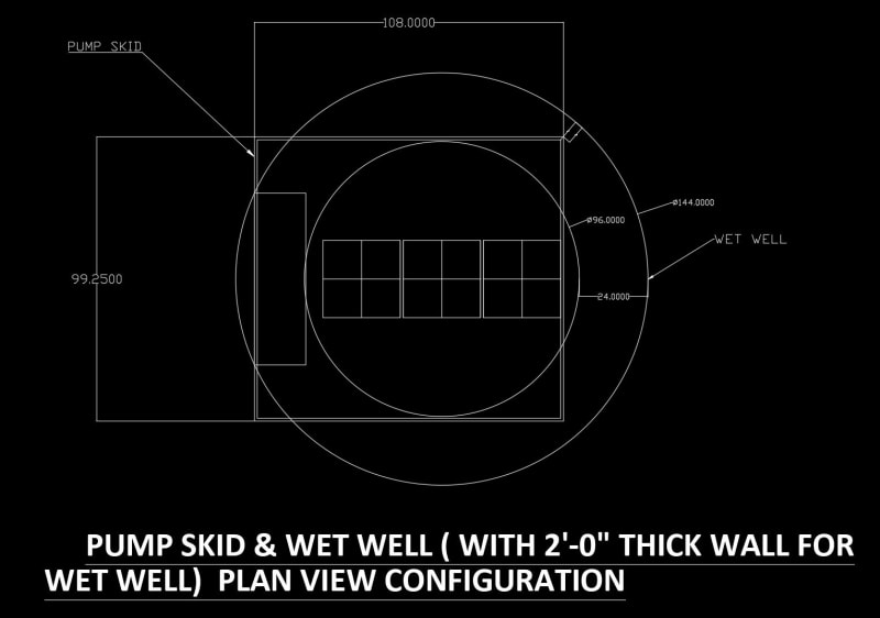

Based on the pump skid arrangement, I have 2 Types to be considered for the wall thickness of the Wet Well. I believe this information should impact which of the two Options about the pavement should be used.
In the images below, the 3 squares in the inner circle represent the 3 pumps. The rectangle on the left is the Control Panel. All of these rest on top of the pump skid, which is 108" x 99.25".
Type 1: This is using a 24" thick wall for the Wet Well, while maintaining the inner diameter of 8'-0". In this case, out of the 4 anchor bolts located at the 4 corners of the pump skid, 2 anchor bolts will be located on the adjacent 1'-0" thick pavement. The total outer diameter for the Wet Well would be 12'-0" diameter (Please see image below).
Type 2: This is using a 15" thick wall for the Wet Well, while maintaining the inner diameter of 8'-0". In this case, out of the 4 anchor bolts located at the 4 corners of the pump skid, possibly all of the anchor bolts will be located on the adjacent 1'-0" thick pavement. The total outer diameter for the Wet Well would be 10'-6" diameter (Please see image below).
I present these cases because I believe option 2 goes really well with Type 1. The pavement would still receive load from the skid due to the 2 anchors on the pavement, but the remaining load would be transfer to the wall of the Wet Well (the Wet Well wall may possibly receive more load due to how close the pumps are to the wall).
For Type 2, the option 1 may work well (having the Wet Well doweled into the pavement). I was trying to keep the Wet Well independent from the paving, but based on potential the annular joint issue, I think it may play into which way to go. The issues would be the minimum edge distance of the anchor bolts. The skid barely extends pass the Wet Well when using a 15" thick wall.
It appears that if I provide the expansion joint detail and notes in the image below, it should resolve any issues with water infiltration at the expansion joint:
I would think that the joint sealant & the backer rod would prevent infiltration of water to the soil below.
Please provide comments if I am missing something regarding the issue of the angular joint.

Should the expansion joint detail & note I show in a previous post prevent water infiltration around the joint?
1) Make sure the wall thickness can accept the anchor comfortably, with leveled surface, as field installation is sometimes more difficult than direct embedment. Also, there is always chances to drill into rebars, and/or splitting the concrete.
2) Yes, when CIP concrete cast against hardened surface, it require flexible joint to minimize separation due to drying shrinkage, and prevent water penetration.
