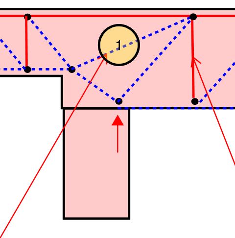

My attempt at a force flow diagrams for the joint.

I'm not convinced that's the end of it. I think there's something going on in the neighborhood of the yellow rectangle below. Localized panel zone shear, some concrete in tension... something. You don't ever make a concrete moment joint and just magically have no other considerations besides flexure to worry about. This just works with out reinforcing or special checking because the demand is not localized or intense.

I attempted to reconfigure things to eliminate the bursting tendency that your model showed. I was able to manage that on the bottom of the slab but the strut that I've labelled (1) below, still creates a similar bursting tendency at the top of the slab, just as it did in your sketch. Something's gotta resist that and it 'aint rebar. The strut below and to the right of (1) is just your usual shear strut coming to ground. (1) is something additional... I think.
Sure, I agree with you that it's concrete tension strength that's keeping it from bursting. Since in plates struts can go in the third dimension (out of paper) I think it's not as pronounced and top reinforcement in the other direction is partially activated. It's true that some tension stresses develop, but they are probably low in standard situations. That's why I said that I agree with both of you, there is some tension theoretically, but plate probably disperses it nicely.

I'm not saying that it's a problem. I'm simply trying to sort out a plausible mechanism to resolve the issue of the bursting force tendency that was raised previously: where it goes and what form it might take. A thing doesn't have to be a critical failure mode to be worth thinking about.
