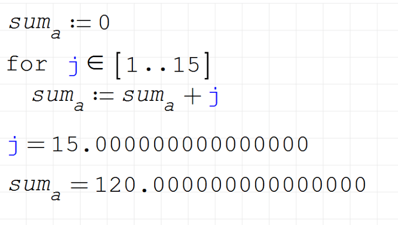

Sep 1, 2024 #1 Albert 3D Mechanical Sep 1, 2024 2 0 0 NL Can someone help me with the following: I'm (obviously) a smath newby, trying to follow the tutorials. so, what am i doing wrong? it sais: sum_a is not defined, but everything looks just the same as in the tutorials...... Thanks! Albert
Sep 1, 2024 1 #2 IRstuff Aerospace Jun 3, 2002 44,345 4 38 US You need to have used sum.a in the sheet prior to this, so something like sum.a:=0 would be good, particularly since the sheet has no idea what value sum.a starts at TTFN (ta ta for now) I can do absolutely anything. I'm an expert! https://www.youtube.com/watch?v=BKorP55Aqvgfaq731-376 forum1529 Entire Forum list http://www.eng-tips.com/forumlist.cfm Upvote 0 Downvote
Sep 9, 2024 Thread starter #3 Albert 3D Mechanical Sep 1, 2024 2 0 0 NL Sorry for my late reply, but thanks a lot! I didn't see this in the examples but yes that was it. Best regards, Albert Upvote 0 Downvote
