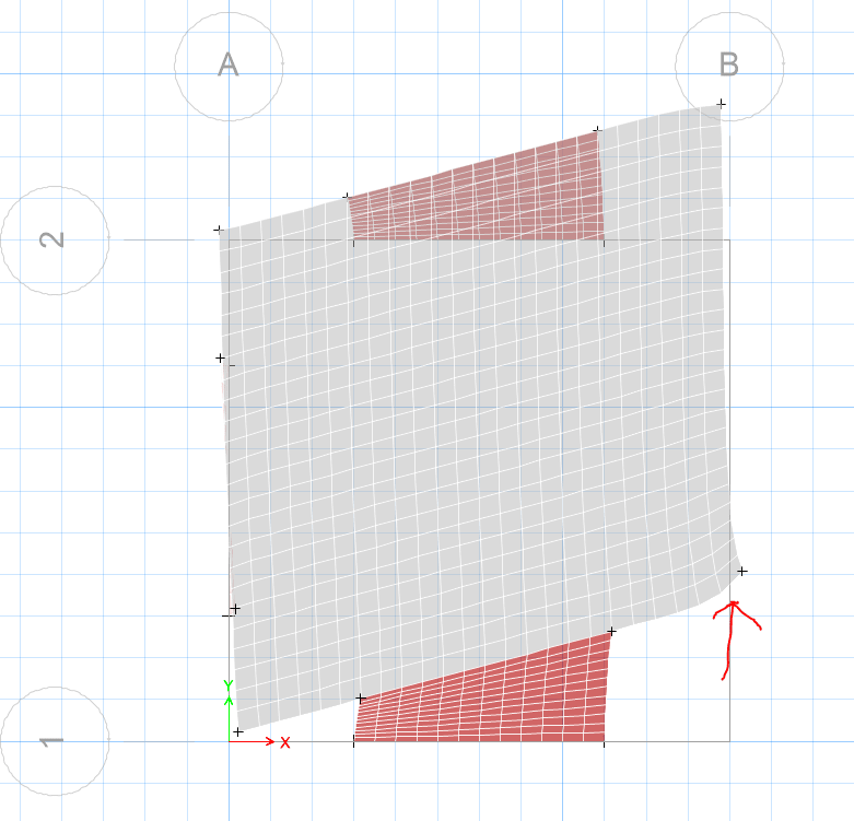

So, I was trying to build a simple model of a three sided box in Etabs (with a membrane element, no rigid diaphragm assumption) and was expecting get a deformed shape like the following, (expected mostly shear deformation of the membrane element):
When I run my analysis, I get the following deformed shape:
Applied loading looks like the following:
A few notes:
- I am unsure why the free (right) edge of the diaphragm does not deflect in a smily face upward manner​
- Floor is modeled as a membrane element​
- Chords and Collectors are modeled as steel beams​
- Self weight is turned off, only load applied is the lateral load shown above​
The other interesting thing is that the axial load in the chords and collectors exactly matches what I would expect (red = compression, yellow = tension):
Questions:
- Do you agree with my anticipated deformed shape?​
- Any ideas on why Etabs shows the deformed shape that it does? Maybe something in our hand methods for diaphragms that does not match what Etabs is doing?​
Seems like the shear stresses in my diaphragm build up as you move page left (like you would typically calculate)
Only thing that maybe wrong with traditional assumptions is there seems to be some non-neglible axial stresses in my membrane element (see image showing compressive stress build up on front edge of diaphragm).
I've played with bringing down the axial stiffness but it makes my deformed shape look very odd.
Thoughts appreciated!

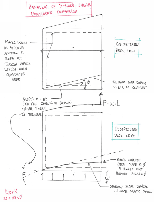

Agree with DaveAtkins half simple span analogy. Simple shear reaction at the Y shear wall, 0 shear at the "cut" end from sum of Y forces , and the couple formed by the X shear walls gives you the equilibrium moment.

Honestly, I think the pure shear deflected shape goes a decent way towards explaining the deflections you were seeing.
That.
We can all be thankful KootK is willing to give up a Saturday to draw free body diagrams of diaphragms[wink]
Seriously, though, that is a nice explanation of what is happening.
DaveAtkins
I gave him a star! Definitely helped my understanding [bigsmile].
Deformed shape exactly match his assumption with the assigned point load at the end
