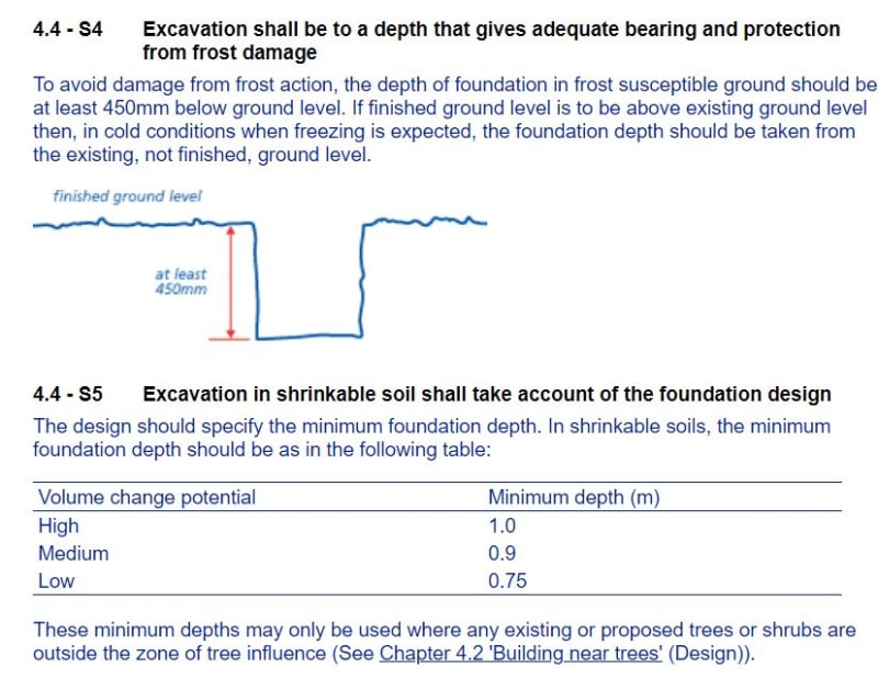

In terms of foundations, as this is in London, I am likely going to specify a minimum 900mm / 1000mm deep foundation. I can imagine it will be below what is existing, I forsee the existing foundations being as you mention a strip or a stepped brick foundation. Therefore I will need to go lower, therefore, it will need some shoring temporarily.

What do you mean 1m down? Do you mean the depth of the actual concrete? Usually it is 450mm deep / below the ground for frost and then yes 900mm-1000mm thick concrete to support the loadings. However, yes will underpin where required / if required.
Depending on the ground min 1m below ground.
Most footings of that time are 18 inches.
LittleInch,
I think we are discussing the same thing?
NHBC guidelines recommends a minimum of 450mm cover of the ground before the start of the foundation for frost protection. The foundation itself with then be circa 750-1000mm typically, therefore, in London I usually specify 1000mm.
See sketch for clarity. I would never simply recommend 1000mm below finished ground in general, as it would make the excavation very deep and also does not tie in with brick and block coursing.
