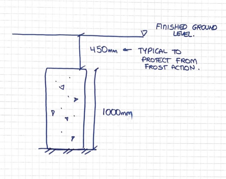

The new extension will also require new concrete foundations, however, I believe owing to this house being constructed in the 1900's to 1920's, I believe it still may have brick foundations, can anyone comment on any potential underpinning issues or considerations that are typical for extensions.

Well I got away with the bottom of the underpinning being 1m below ground, but the ground beneath was virtually commercial grade sand and gravel so the builder persuaded the building inspector he didn't need to dig any more. Good old London clay might need to be deeper.
Underpinning is a little different to new foundations.
Hi Littleinch,
Yeah it is case per case, maybe a reinforced strip is more suitable for the one you mentioned.
This current one I have is London clay, so I will be specifying 450 below and then 1m deep. So excavation will be at least 1.45 - 1.50m deep.
