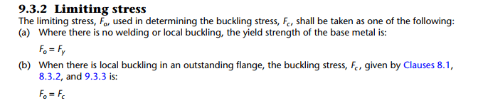

Agent 666 - can you give me your source for saying the tensile strength is different than the compressive strength for aluminum (assuming buckling does not occur)? The CSA design guide says otherwise:
Also, yield stress is stated at the 0.2% offset for steels as well so how is aluminum different there? I get there's a different shape to the stress strain curve. The CSA aluminum design guide uses the yield strength of the material along with the plastic section modulus to check the resistance of a member in flexure. The same method is used for steel. There are many grades of steel as well as aluminum. So if the youngs modulus, yield strength, and limiting slenderness ratios are all accounted for, where are all these remaining many more differences in design than steel for a beam in flexure?

Hi Deener, for example this screenshot is from my own local aluminium design standard (Australian & New Zealand), you'll note for example strength depends on temper and type of design action (and values used vary considerably):-
It could well be your aluminium design standards hides this behind the scenes in the equations, or maybe it neglects it completely, or doesn't take into account any benefit afforded and only uses the lesser value. I'm not familiar with CSA aluminium standard to be honest.
