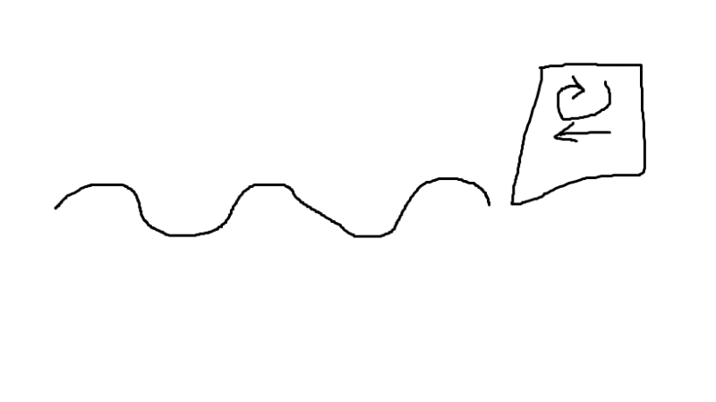

Hi, I am trying to realise sinusoidal motion of my tool and at the same time, my tool is vibrating elliptically.
Right now, I am using Displacement on the reference point of my tool, initial step all 0, step 1 allow X and Y to move.
For the vibration of the tool, I use Velocity with Periodic Amplitude for X and Y respectively.
I input values for amplitude, and I gave a initial speed for X direction to allow forward motion by giving a value for initial amplitude in the Periodic amplitude. For Y direction, I enter 0 for initial amplitude.
(Because in Periodic Amplitude, initial amplitude= initial speed)
However, in order to realise sinusoidal motion of the tool, I cannot give a value for initial amplitude of Y direction, as it will go only one way, which is not what I want as sinusoidal motion requires up and down motion in Y direction.
I thought of using subroutines but there is no subroutines available for Velocity.
Actually I was told that I can realise this motion without using subroutines, and I have seen ax example of a 2D simulation of elliptical vibration cutting in sinusoidal motion.
It would be great if someone could provide some advice. Thank you.

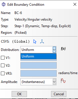

But how do I input subroutine into Velocity boundary condition?
As we can see, there is no 'user-defined' in the options.
However, there is 'user-defined' in the Displacement/Rotation BC.
Use keywords to define this type of BC with VDISP:
*Boundary, user, type=velocity

@Vxxxxx, you haven't really explained what the problem is using periodic amplitude. As you said, specifying 0 for the "initial amplitude" in the y direction will result in sinusoidal motion in the y direction. Isn't that exactly what you are trying to achieve?
Hi, if I specify 0 for the initial amplitude in y direction, the tool will only move in one direction(positive or negative y direction) while vibrating vertically. In order to realise sinusoidal path, the tool should move in both direction (first positive then negative y direction or vice versa) but i can only input one value into the initial amplitude, either positive or negative value.
It sounds like you could achieve this centered sine wave with a boundary type=displacement rather than velocity.
Using velocity it will, as you said, move in one direction and then reverse back to the original position.

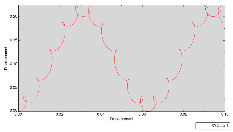

Here is an example of a higher-frequency elliptical motion superimposed on a sinusoidal motion using periodic amplitudes. I think you are trying to do something like this. Maybe it will be helpful. The motion will not be affected by contact unless there are numerical problems with the model.
[pre]*Amplitude, name=Amp-1, definition=PERIODIC
10, 10., 0., 0.1
0., 0., 0., 0., 0., 0., 0., 0.
0., 0., 0.2, 0.
*Boundary, amplitude=Amp-1, type=VELOCITY
RP, 1, 1, 1.
*Amplitude, name=Amp-2, definition=PERIODIC
10, 10., 0., 0.
0., 1., 0., 0., 0., 0., 0., 0.
0., 0., 0., 1.4
*Boundary, amplitude=Amp-2, type=VELOCITY
RP, 2, 2, 1.
RP, 3, 6, 0.[/pre]
