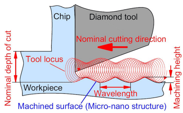

one last question, If I want to vary and control my amplitude throughout the cutting process instead of assigning sinusoidal motion (as shown in figure below), do you have any suggestions?
I am planning on using subroutine VUAMP. Thank you.
I agree: In this case you will need user subroutine VUAMP.
Noted, Thank you very much @OldNail.
