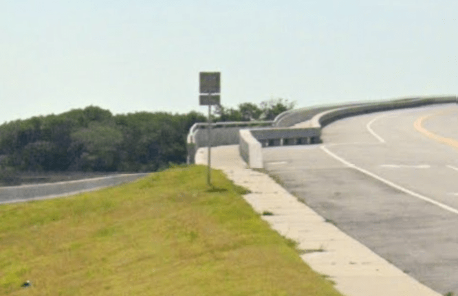

This is the picture of the end of the cycleway / footpath on the other side of the road.
Equally unlit and no warning.
To be a little fair this makes it look worse than it is as it has an angle on it but would make you walk / cycle another 400 yds at least tog et back to the same point.
Nothing on the other side has any notice saying pedestrian or cycles or sudden end.
A definitive failure in design for me.
That particular spot on the north side of the road also leads to the inside of a looped ramp from the road over the bridge to the surface street underneath, with nowhere for such hypothetical pedestrians (or bicyclists) to go other than crossing a street with no marked pedestrian crossing - or backtrack for a long walk to a marina and boat ramp area.
The crash location is to the right of that frame on the south side of the road.
Given the length of this bridge, and what's surrounding it on both ends, I would expect pedestrian traffic volume to approach zero, which means this should have been a bicycle lane, which means it should have been extended another hundred metres or so along the roadway instead of doubling back underneath (and provided with a proper marked road crossing). And zero lighting and zero signage.
I've changed my mind: General design failure. Including being an engineering failure.

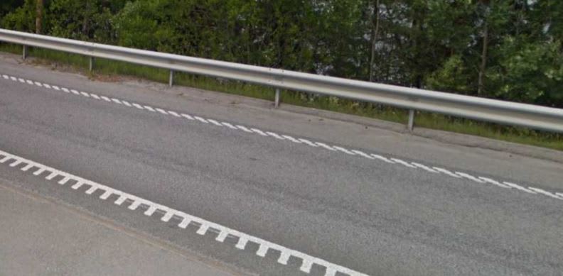

Another solution that is used here in Sweden, but then mainly on car roads, is to paint striped lines, which means that the steering wheel starts to vibrate if you start to cross the line.
The same principle could be used here, to simply make grooves or paint on the walkway, in a way that makes it necesary for the cyclist to slow down and or perhaps realize that there is something that you should be aware of.

From what I know of living in JAX for three years(and the South my whole life) the sidewalk may have been included in the bridge design either as a federal highway requirement or to qualify for some matching funding rather than utility to non-motorized road users. The photographs make it appear as a strictly utilitarian design (i.e. 'designed to specification'). Is this an example of well-intentioned infrastructure mandates/incentives without practical guidelines?
Both the side with the turns and ramp and the other side loop around onto a sidewalk beside the surface street that loops around beside the bridge before going to 4-way stop under the bridge. At that point, there are no more side walks in any direction. Given the lack of sidewalks on the accident side and rather poor sidewalks on the other side, I would suspect the walkways on the bridge were put there for some currently unknown "future" use or they were spec'd in because someone forced it on the project, but given minimal effort because there were no real requirements besides being there. Similar to those suspect spots for light poles being there but not used.
The ramp area as a minimum should be lit at the corner and especially under the bridge, or the sidewalk should just be blocked off from use.

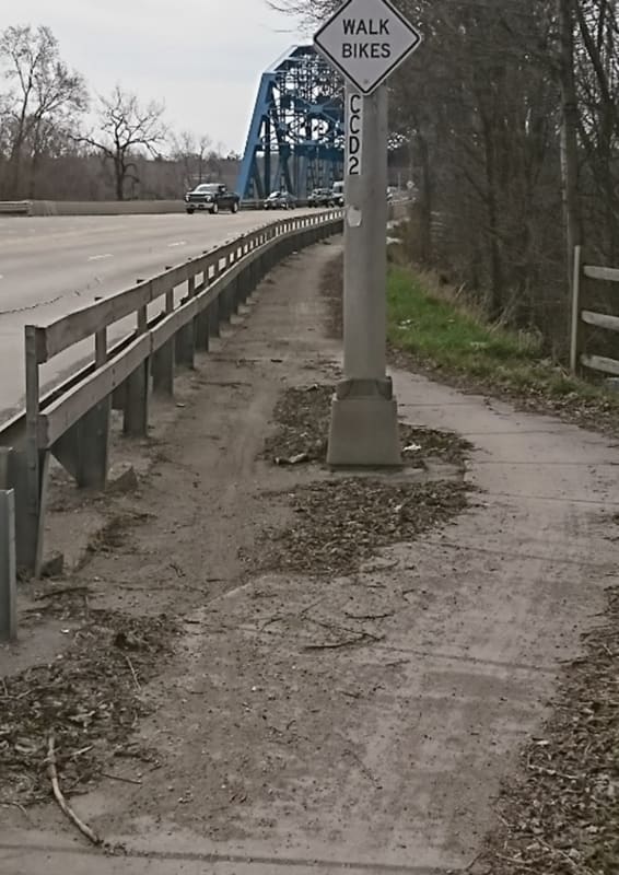

Here's the bridge I mentioned:

John... I notice the 'bike path' continues on the LHS of the sign...[pipe]

I would have 6 punctures by the time I got through all of that debris and gravel.

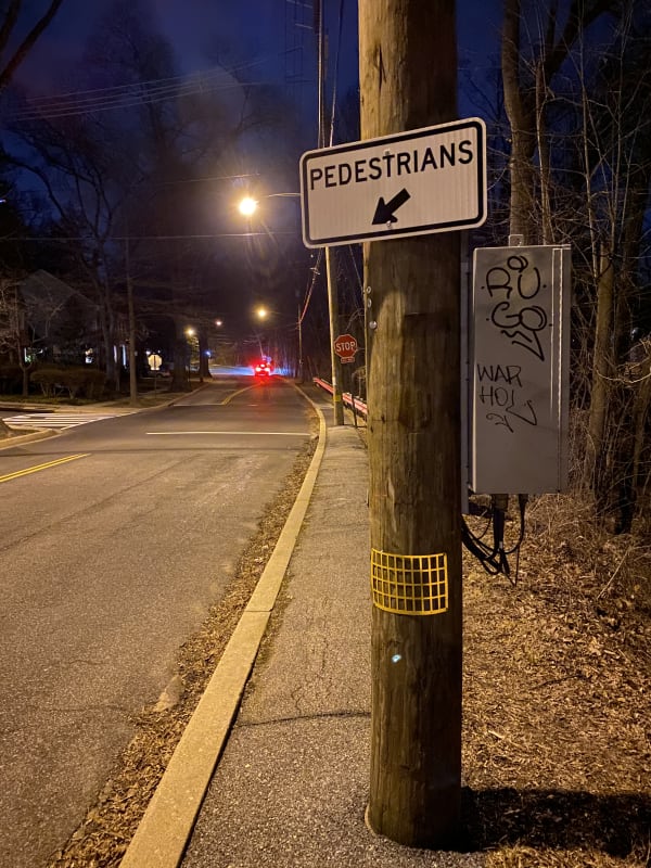

bimr, similar to your sign, I saw this on a walk the other night:
I guess that sign is up so that you don't accidentally walk into the electrical box.
