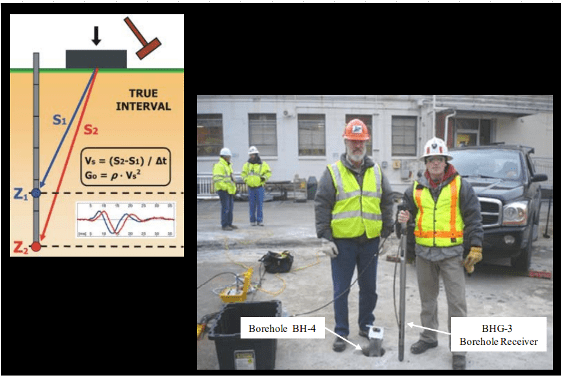

The article that came with the photo didn't say the magic word - where the 30m/100' should be taken, but kind of indicative/suggestive.
The 100ft begins at the ground surface. It determines the amount of lateral ground movement the structure is likely to have to sustain during the design seismic event (and therefore the required ductility of the structure). Solid rock moves far less with the same energy than softer soils.
The depth to bottom of footing for shallow foundation or bottom of pile cap for deep foundations should be discounted from the total 100 ft. The site specific response spectrum is calculated to bottom of footing level anyway. The bottom of footing is where a structure transfers its loads to and receives seismic loading from.
