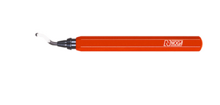

There is an inexpensive tool for this. Drill a hole, and use a hi-lo gauge to accurately measure the thickness. If you are concerned about the burr inside the hole affecting your measurement use a deburring tool (in red below) before measuring. I've done this multiple times.

I was curious, so I just watched a video on the manufacturer's website. I'm still not sure exactly what size hole is required, but pretty big. Definitely not a pinhole. Looks to be about 1-4"-1/2", Neat tool though. It looks like it's actually intended to measure various aspects of pipe fit-up when welding sections of pipe together.

Obviously it's not going to be a pinhole but you can offset the ends when you insert it. If you are careful you might be able to make a 1/4" diameter hole work. Though a 1/2" hole is plenty. We keep a box of these metal plugs for when we need to drill. If you want something completely non-destructive you are going to need to pay more. Or drill a pinhole with a bent wire and get a very approximate result.
