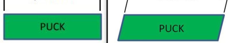

If I understand the OP's question correctly, it is a rather direct question:
Given:
Rectangular plate dimensioned with ± for size (generous and liberal tolerance)
ASME driven drawing
Question: Could the left wall's perpendicularity (or right wall's perpendicularity for that matter) to the bottom surface be limited by the default angular tolerance such as:
Unless Otherwise Specified tolerance on angles = ±1°
IS the perpendicularity limited by those DEFAULT tolerances applied to the implied 90°?
greenimi,
As per ASME Y14.5?
Yes.
JHG

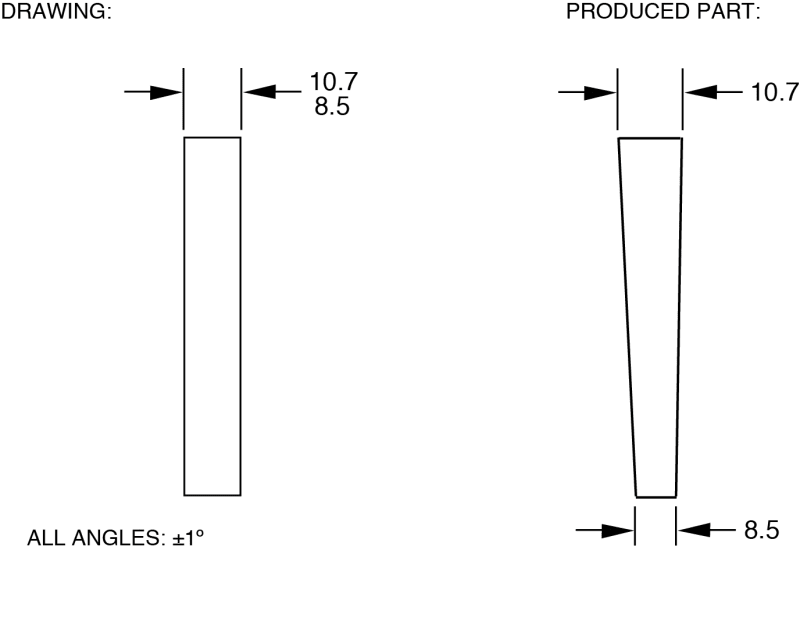

Greenimi, I think the questions is still a little different from what you have shown, because on your green part the size dims are still perfect. But the OP mentioned having a large size variation.
The sketch below shows how a part can utilize the size variation across a FOS to maximum effect, thus creating angular error.
Using my sketch, would the 4 corners shown in the "produced part" still have to comply with the general tolerance for angles? I would say yes.
It's the same answer you guys were saying, but I just wanted to put a different spin on the illustration of the question :)
