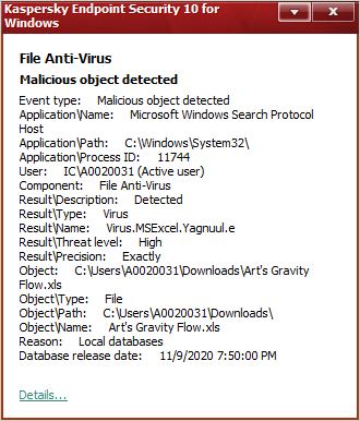

Did anyone else get an alarm on Art's Gravity Flow.xls?
Good Luck,
Latexman
I did not get it, as downloaded Art's spreadsheet from a CHEE resources forum not from pierreick's attachment above.
Thanks and Regards,
Pavan Kumar
Looked at this again and now see what you are talking about.
