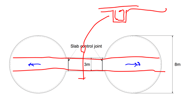

Hey all. We have a building that is being built on an expansive clay site. It is built using shotcrete concrete domes connected by a domed hallway. The slab is polished concrete so is highly susceptible to shrinkage cracking at the hallway. As a result, I am wanting to place control joints in the hallway slab at the locations shown in the image (dashed lines are walls of the concrete domes above).
I realise that dowels through slab control joints are best using a non-bonded dowel (such as greased or sleeved etc). However, since this is a reactive site and the concrete dome shell is above, I are trying to avoid any hinge action at the joint and would want full moment transfer. Therefore, I was thinking of using dowels that have full development on each side (eg. non-bonded with 500mm lap each side to slab reo). Would this at all reduce the plastic shrinkage cracking in the slab, or do you think that non-bonded dowels are the only way to go?
So based on your question, you are trying to maintain a full dome-to-dome rigidity where the circular domes meet the hallway dome, correct?
The idea of a control joint is to induce a crack along a straight "joint" that you dictate - which is an attempt then to avoid random, irregular cracks elsewhere.
If you de-bond any reinforcement that is extending through this induced straight-line crack, then you defeat the ability to have a rigid moment capable intersection I would think.
For expansive clay sites I would think that two large masses tied together with a narrow hallway like this would want to be separated with expansion joints - allowing each of the three sections to move somewhat unhindered as the clay will move up and down in all sorts of combinations.
Don't try and restrain it against rotation. It defeats the purpose of the articulation joint.
Just to clarify, the goal is to reduce shrinkage cracking in the polished concrete slab. But at the same time keeping the concrete dome (including the dome-to-slab starter bars) as a complete structure since the dome design and shape requires it to be a continuous structure.
What do you think is the main cause of cracking in polished concrete slabs? Is it the initial plastic shrinkage cracking or long term shrinkage cracking? My thought was that by having 2 separate pours (but making the reinforcement bonded and lapped each side of the joint) it would reduce plastic shrinkage cracking since this occurs prior to reinforcement bonding? (but would have no affect on long term shrinkage cracking) Is this correct? Or perhaps it is better to keep the slab as one continuous piece and place saw joint to control the cracking.

Moment connections that allow translation are very difficult to accomplish. That type of connection (for that matter, any full moment connection) large enough to provide moment restraint to a structure of that size would be huge and expensive. I don't think it's a good idea to attempt to provide moment restraint between the domes. You're going to be much better off to design and detail the 3 pieces to be independently stable and linked by non-bonded dowels all around the connections - walls and roof, too, not just the slab, at the locations you've marked.

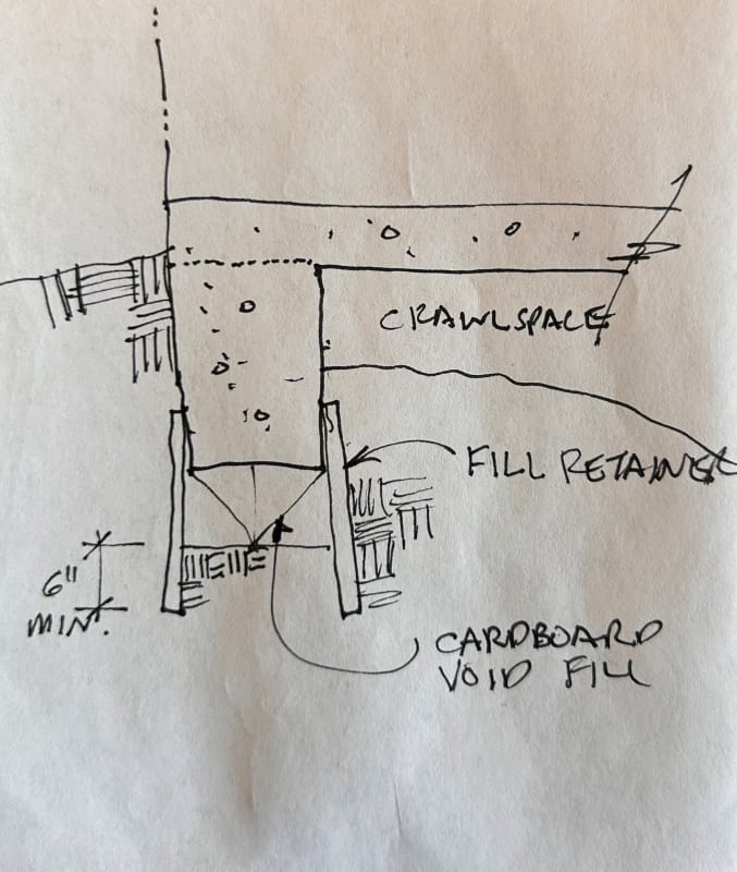

Another thought. In all my years of design on expansive clay, the most positive thing to do for major structures was always to support the structures on drilled/belled piers and perimeter grade beams separated from the soils with void forms and fill retainers.
Basically creating a spanning concrete foundation beam (on piers) with a 6 to 8 inch void below the beams.
The fill retainers are typically 1 1/2" thick precast concrete planks - say 18" wide x whatever length manageable - leaning on each side of the grade beam to keep adjacent earth from filling in the voids over time.
The piers are typically reinforced with 0.75% vertical reinforcement +/- and belled to help hold down any friction uplift forces by the clay on the piers.
For a large domed structure like this and with expansive clays, that would be to the way to go to ensure minimal movement.

I think you need to decide if you want the structure to be completely rigid, or if you want to allow for some movement.
If the dowels are greased, then it's an expansion joint in my book.
If the dowels are not greased, or the typical reinforcement is continuous across the joint, then it is either a construction joint; or a control joint. Many engineers will reduce the reinforcement by 50% at a control joint to intentionally create a weak spot.
Just looking at the geometry and relative sizes of your structure, I like the idea of an expansion joint. Your structure is shaped like a weightlifter's dumbbell with large masses connected by a small mass. The inner connecting element will not be anywhere near as stiff as the outer domes. If either of the domes want to move, then you will likely crack the connecting element.
Put me down for expansion joints.

My fear with using the grade beam strategy here is related to JoelTXCive's concern for the unique shape of this barbell thing in plan. You probably could run a stiff grade beam end to end that would iron out the differential movement end to end. But, then, the bells on the barbell would tend to twist as shown with the blue moments in the sketch below. Gross. To iron that out, you almost need to use a giant box beam for your grade beam in order to resist the twisting tendency with torsional beam stiffness. And I'd have to think such a strategy would be too costly to represent a practical solution.
Well damn... I've always worried about the earth filling in the void and have never even heard of "fill retainers".
In my market, we specify "frost cushion" which is supposed to be permanent (questionable) and squishy enough to not resist upwards movement of the clay. It's then a battle to get contractors to actually use this stuff instead of void form which disappears and surely does let the earth fill the void in the absence of fill retainers.
@Brad805: what are you seeing in this regard?

Here's a rough sketch of the idea of using fill retainers to separate grade beams (spanning from pier to pier) from expansive clay soils below.
These would usually be about 1 1/2" thick reinforced with a welded wire mesh - usually simply cast on a 4' x 8' sheet of plywood on site using 2x4's as side forms:
@JAE: thanks for that. Do you get any balking at the cost of the precast fill retainers?
