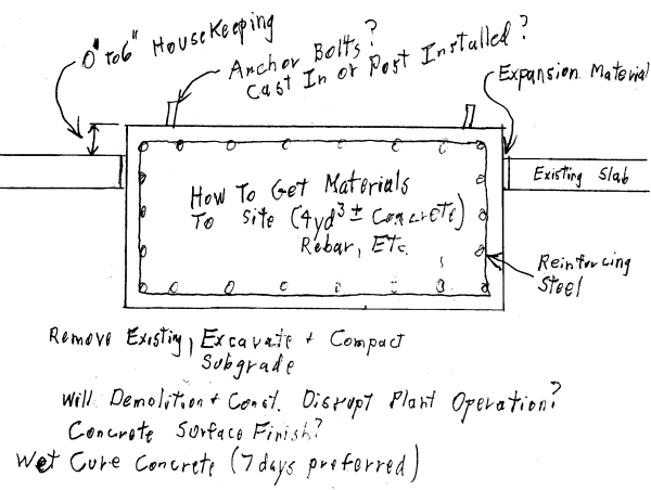

TSHW - This project appears fairly simple and straight forward, but I'll over emphasize the various aspects of doing this type work in-house.
You will be the Project Manager, Structural, Civil, Geotechnical & Mechanical Engineer, and also (I assume) Construction Manager and responsible for technical side of contractor Procurement and bid evaluation.

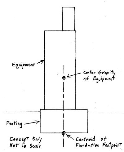

Here is a conceptual sketch of a few of the issues you need to plan and address:
Also establishing potential foundation loading from equipment operation, maintenance, seismic, etc.
The equipment is not necessarily centered on the foundation. It's important to position the equipment's center of gravity as shown below. If this is not done, load on the foundation will be "eccentric" which will effect how supporting soil is loaded. The center 1/3 of a footing (in all directions) is called the "kern". Google on "footing kern" for more info.
Some of the items I have listed above will be the Contractor's responsibility (like getting concrete to the work site), but if you don't think things through they become your problem when his actions effect plant operation. Read over the above and let us know your thoughts.
That's an awful lot of reinforcing in your 6'x6'x3' blob... shrinkage? in a 6' length?
