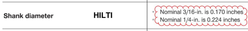

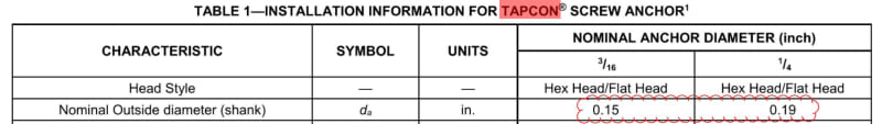

Here is an image of 1/4" dia x 4" long TAPCON and 1/4" dia x 4" long KWIK-CON II.
Notice the difference on the shank diameter and thread type.
I have conducted load pull-tests of both types and KWIK-CON has superior capacity - even in cracked concrete.

Agree with Ingenuity. Personal experience here - Tapcons will shear off - KwikCons won't. A 1/4"Ø KwikCon is also def. larger than a 1/4" Tapcon.

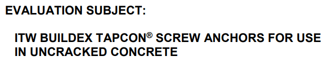

Tapcons ICC-ESR are evaluated for uncracked concrete only.
