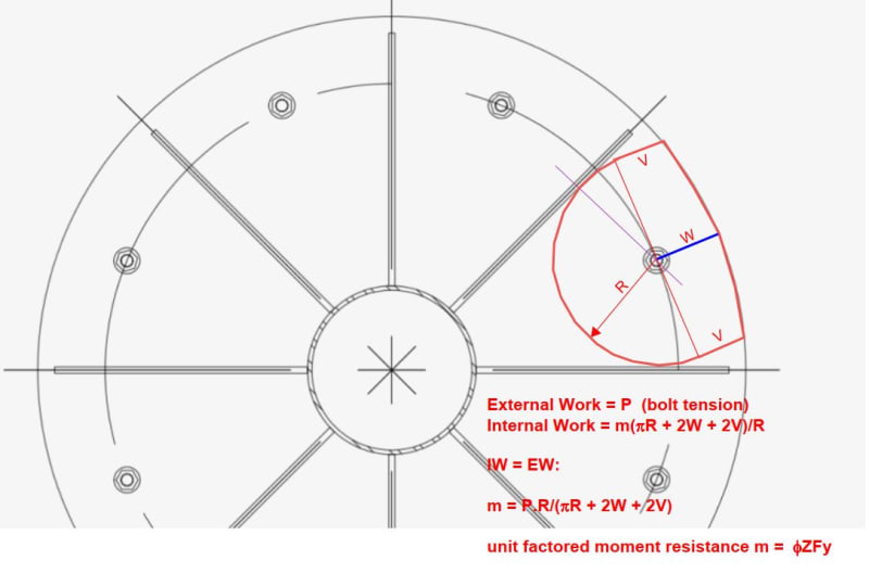

I don't think there is a basis for any multiple of t as the width. Usually a 45 degree angle is used, as kind of a quick and dirty assumption that it will be more conservative than a proper yield line approach. If you were to crunch the actual yield lines you would see the thickness does not affect the controlling pattern.

The effective width is more a function of span and support conditions than it is plate thickness. A longer span mobilizes a much wider effective width. For a monolithic steel plate you will typically obtain an effective width similar to the span distance, which is reflected in Celt83's yield line drawing.

I would have answered this differently a couple of months ago, but I think this is the correct failure mode.
I suspect it would be close... thanks, BART. I'll see how it compares to what I used. Project is already done and out.

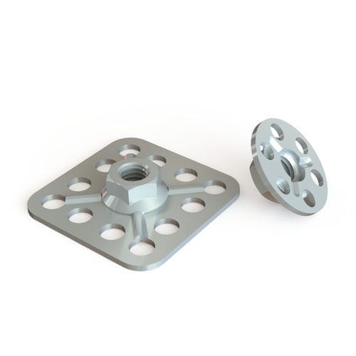

Also, sine you want to increase flanged diameter of base plate, why you don't apply double nuts technic ?
