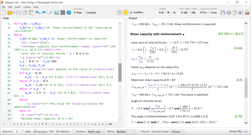

Excel and SMath use two completely different approaches and both are useful in different cases.
SMath (like MathCAD) use visual eidtor to enter formulas and Excel is a spreadsheet based solution. It creates relationships between cells by formulas in text format.
There is also another popular approach:
to enter formulas in coding/programming style (plain text input) and get a formatted report to Word/MathType. It also has many advantages. The most important one is the flexibility. You can easilly split both the solution and the report contents, depending on some intermediate values, like in Calcpad:
You can also use units, numerical integration etc.
Are you referring to Excel when you can input formulas in code and have it spit out in Word/MathType? Also is Calcpad a free software?
Thank you
