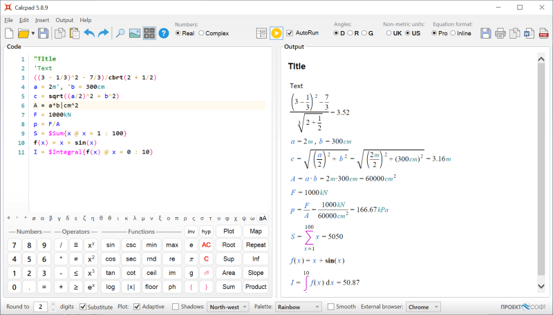

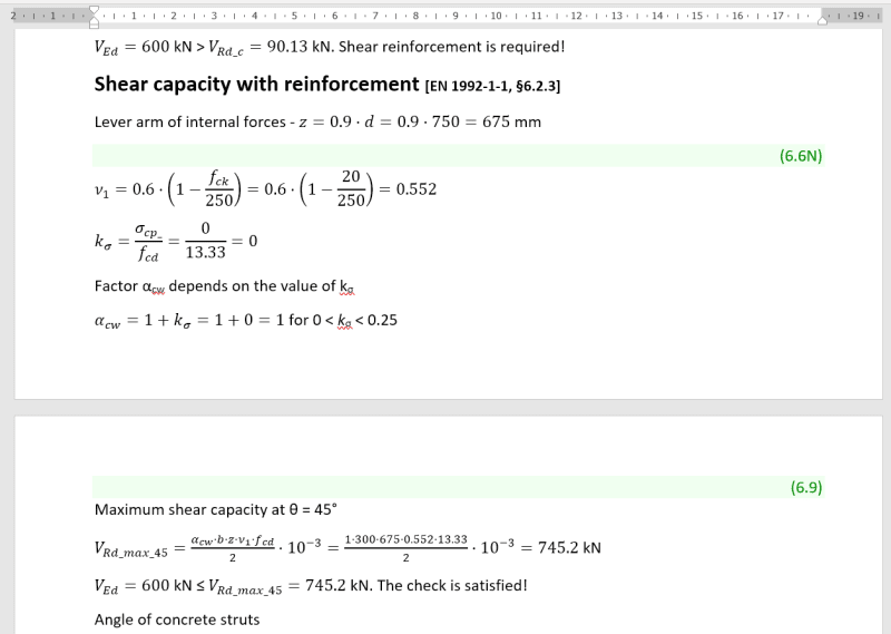

Cells with formulas inside are not exactly "coding" as we do it in programming languages. In Excel, you can use VBA for that purpose, which is a very powerful option BTW. Also, Excel does not document your formulas to MathType. You need to type them once again on the top. You need some third party software to do it automatically. Calcpad gives you directly a complete Word document with all of your formulas and text. For the example from above, it looks as follows:
You can try it yourself, if you go to click "Run" and then "Download docx".
Other examples for "coding" based systems are Mathematica or Matlab. Calcpad is not that powerful, but it is simple and easy to use. It is free and also open source. Check this GitHub repo:
Calcpad certainly seems interesting...one my office would have with it is that it has a larger barrier to entry in that you need to learn to format via code rather than a graphical input. Can see a lot more time trying to catch people up to speed rather than sticking to a SMath/MathCad type input. I do like how clean it looks.
You do not need to learn to format via code. :)
Just type your equations and the software will do the job for you. You will see the immediate results in the output window on the right.
I have used both Excel and MathCAD for many years. I could say that coding is way much faster than graphical editing as an input method. So, if you search for speed, this is the right choise.
You need to learn almost nothing to start. Put titles in double quotes " and text in single quotes '. Outisde just write your formulas. I am not trying to convince you to abandon SMath or Excel. I am just pointing out that there is another approach, except those two that is worth to consider. Each one has its own advantages.

Calcpad supports Html inside text comments. This provides almost unlimited capabilities to format your notes as you like. Actually, Calcpad uses Html and CSS internally to render the output. That allows it to be easilly integrated with web sites:
There is a starting template file c:\\Program Files\Calcpad\template.html. If you need a custom designed header/footer for each document, you can add it to the template. If you are not familiar with Html, you can send me the design and I can make the template for you.
Another, even easier option is to create a MS Word template, make it default and export the output to Word. It will be filled inside the template. Calcpad does not have its own editor like BlockPad (which I like it BTW), but you can use directly MS Word or Libre Office for that purpose. For me, using Word as a text editor for my calculation notes is much more convenient. Exporting to native Word files is one of the Calcpad's most valuable features.
