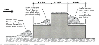

Another case is show in the article. My question is what is the fetch distance for Roof C leeward drift?
Similar to the previous argument, if the length of Roof A is less than the required fetch distance given in the table (264 feet), then the roof C leeward drift would only be the length of Roof B.
Having said that you can see that he comments that the roof C drift could be due to Roof A, B, and the ground snow. Any thoughts on this?

FAQ 9 actually highlights the discrepancy though in the two methods (i.e. 0.85 reduction vs checking fetch length). I have an older edition of O'Rourke's design guide (it's for the 2005 ASCE 7 snow loads so please correct me if it has changed). Below is the figure used in FAQ 9 and the question is "what is the leeward drift on roof C"
There is a windward obstruction/trap caused by the parapet. In the FAQ they explain that the windward trap is somewhat efficient at trapping snow, therefore we use 0.85*L_A + L_B (which is 0 feet) to find the Leeward drift. This approach neglects the height of the parapet. This solution seems to contradict the notion that a ramp must first be formed on roof A before the snow is transported to roof B which in this case is 0' long so it goes to roof C. As I worked out in the first example where roof B was not 0' long, the fetch distance for the leeward drift on C was only equal to L_B (because h_o was sufficiently tall), so in FAQ9 example the leeward drift would be 0.
If I go back to my example which has the parapets 1 and parapet 2. The windward drift would be L_hi + 0.85*L_low if I use the FAQ9 logic, but if I use the required fetch distance it would only be L_hi.

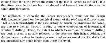

Looks like this has changed for ASCE 7-16. See below:
Having said all this I agree that it seems way too unconservative that with only a fairly short parapet you could ignore leeward drift and your only concern is windward drift.
I believe the rationale that O’rourke uses is that one of the two will control so there’s no reason to consider them simultaneously, except for in the case of RTUs. The drift provisions are predominantly empirical.
