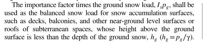

I'm working on a project where the ground snow load is 175 PSF. That's about six times what I'm used to and has prompted me to consider snow drift on decks in a little more detail than I've done in the past. And it turns out that I have questions. How do we feel about the interpretations shown below? Consider the bits highlighted in yellow to be questions.

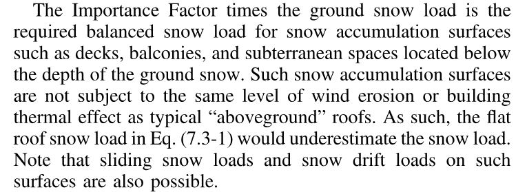

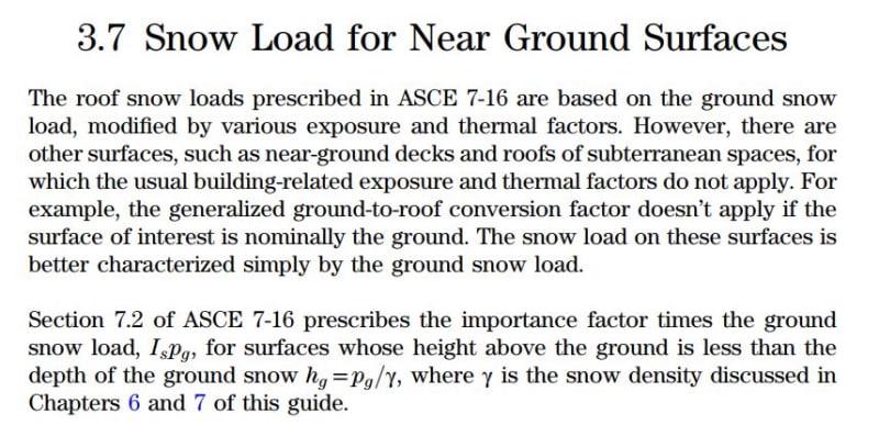

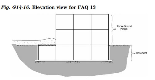

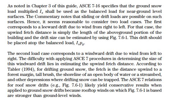

So ASCE 7-16 and Rourke's guide to snow do cover this somewhat, as shown below. This confirms a lot of our own conclusions but, unfortunately, provides no simple answers. I feel like there should be some maximum ground fetch based on the width of the building but I don't know that that should be.

I'm planning for drift to the level of the second story and no higher this go 'round.
