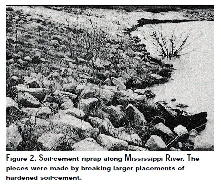

Now i want some article or where can i find something to read about soil-cement riprap.
I read i short article about this tipe of protectio in Concrete construction article and in a study at Mississippi River but i don`t understand how this riprap are made.Can anyone help me?
typical method for soil cement bank protection
They made bank protection and then drilling / punching / broken the bank protection? (this type of protection look like big stones >500 kg)-riprap
