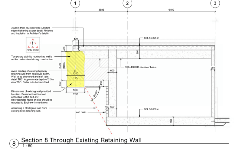

Hi all.
I have a question that has no doubt been covered on this forum but I can’t find a solution.
Does tabulated data exist covering the angle of dispersion through different soil types?
I am to believe (depending on what is being checked, i.e settlement etc) that the angle is 30 degrees to 45 degrees. Is this 30 degrees from the vertical ( or 60 degrees from the horizontal as shown).
I have a gravity retaining wall in bed rock and I’m trying to argue a steeper load angle through the ground beneath to avoid an adjacent structure.
Any opinions, discussion or assistance as always is welcome.
Luke

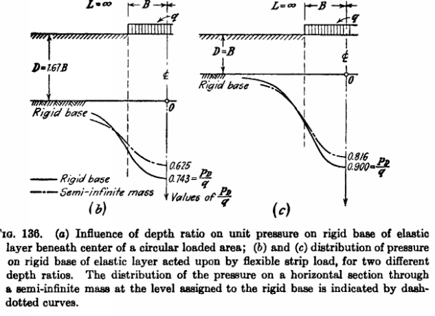

The 2:1 rule is pretty common for depth to radial distance. A good reference for depth of influence is Terzaghi. Here is a sample from one of his books.
Thanks GC bu till be perfectly honest i dont quite follow that above.
Any of above method of spread pertaining "bed rock"? Just curious. I think at least the properties and condition of the rock need to be addressed.

The image below will hopefully clear a few items up.
I am interersted in the spread from the existing retaining structure highlighted yellow to the new basement retaining structure. this is the permantnt solution but also for the temporary works (which is a more complicated hing in itself and could sparka whole new conversatino)
