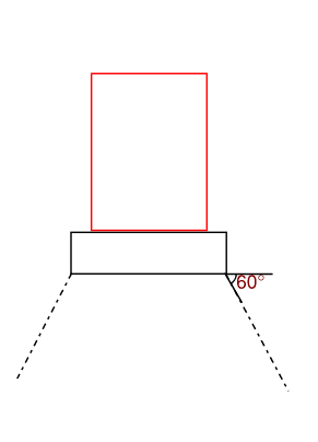

Does tabulated data exist covering the angle of dispersion through different soil types?
I am to believe (depending on what is being checked, i.e settlement etc) that the angle is 30 degrees to 45 degrees. Is this 30 degrees from the vertical ( or 60 degrees from the horizontal as shown).
I have a gravity retaining wall in bed rock and I’m trying to argue a steeper load angle through the ground beneath to avoid an adjacent structure.
Any opinions, discussion or assistance as always is welcome.

The 2:1 rule is pretty common for depth to radial distance. A good reference for depth of influence is Terzaghi. Here is a sample from one of his books.
Thanks GC bu till be perfectly honest i dont quite follow that above.
I have always used and assumed 45 degrres. But I am lead to believe that is conservative.
For my current problem I want to change this angle of influence to avoid a nearby property and being in bed rock I feel like this is fine, (but have nothing to back to this up so obviouslty wary!)

Sand and Gravel = more like the 45 deg.
If siltly / clay = more like the 60 deg. from horiz.

The image below will hopefully clear a few items up.
I am interersted in the spread from the existing retaining structure highlighted yellow to the new basement retaining structure. this is the permantnt solution but also for the temporary works (which is a more complicated hing in itself and could sparka whole new conversatino)
