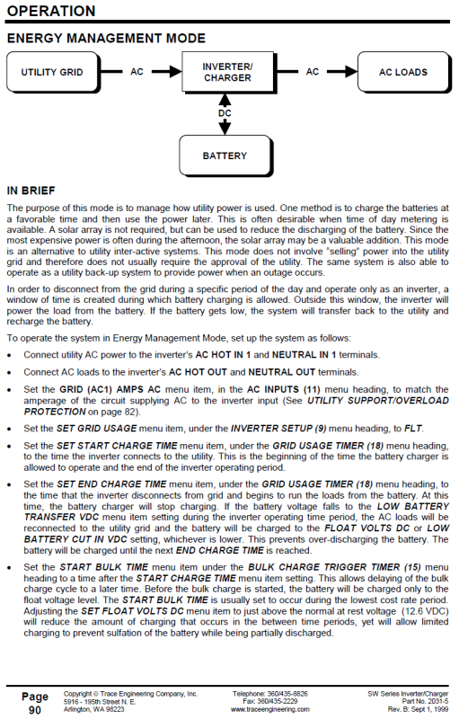

If you had a device that would do the below, would you be satisfied?
It's not on the market any more, but they can still be bought used for ~300 USD (yeah e-bay)
This excerpt if from my Xantrex SW series machine. The Xantrex DR series is smaller, cheaper, does the same stuff.
These devices have 20 other modes of operation so if this isn't suitable, maybe another is.
Something I notice in your OP is the hint of an assumption that the inverter would be involved in charging the batteries in conjunction with the solar panels.
Normally it wouldn't be, since the solar panels can charge the batteries directly, or through a charge controller (which is better).
This device, being an inverter/charger, not just an inverter, would allow you to charge the batteries from the grid, if necessary after many cloudy days, for example.

Thanks for the info Spar!
I was actually considering building something that does this. I hadn't seen anything that did it except the guy in here with the solar refrigerator controller thingy, but then his has never actually made it to the market.
The DR series is nice.
