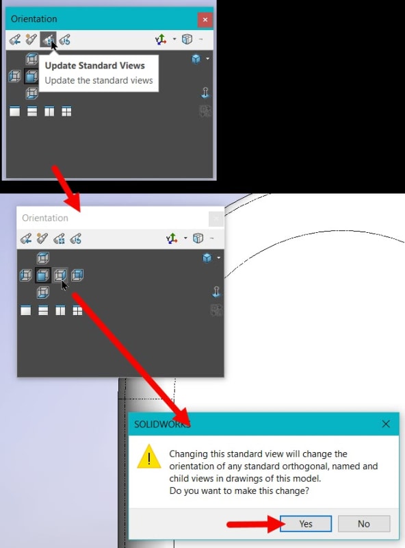

Watching Catia go through that process looks hard and complex to me. a lot of clicking and a lot of typing. I pick a starting point and go with it. I can always change the orientation. however it does not change the XYZ, but I can make my front view my right view. For example if I am looking at the front view and I want it to be my right-side view then I click the space bar and select the 3rd telescope. select the right side, it gives me a message I say yes, and tada the front is now the right.
